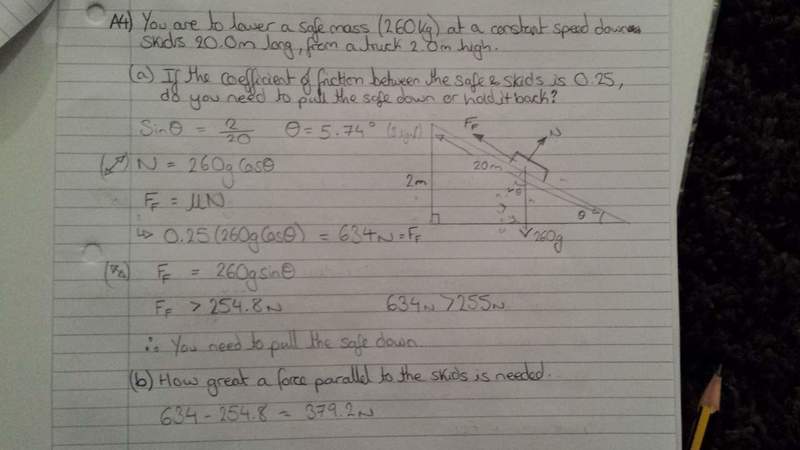

You are to lower a safe of mass 260kg at constant speed downs skids 20.0m long, from a truck 2.0m high.
a) If the coefficient of friction between the safe and the skids is 0.25, do you need to pull the safe down or hold it back?
b)How great a force parallel to the skids is needed?
F=μN
Please see image
  • Handwritten physics solution on lined paper showing a free-body diagram of a 260 kg safe on a 20 m skid tilted 2 m high, with the forces F_f, N and 260g labelled, and working for friction and the required pulling force.
Looks correct.
