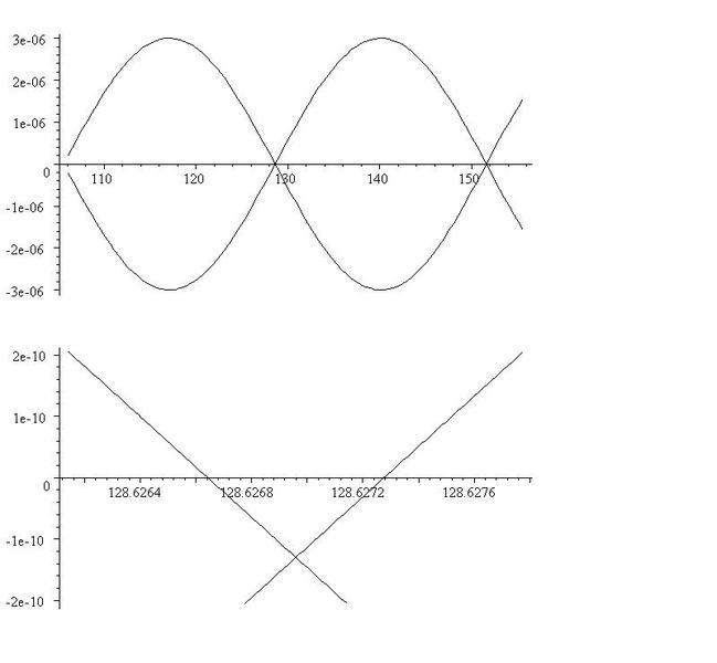

I've attached a couple of graphs that resulted from some calculations that I made. The top graph shows the image amplitude vs observer time (in years) for a slow-moving binary system. The bottom graph zooms in on a portion of the graph where the images coincide.
The coincidence event in this case occurs off-axis at an amplitude that is roughly 1/30000 of the full amplitude of the observed motion.
Later, I will post the details of the calculation so that it can be checked. If this doesn't happen today, it might not happen for a few days.

robphy said:
In particular, (if my calcuation is correct) it seems that for large orbital speeds, the eclipse does not appear in line with the axis of rotation... but on the receding side of the axis. Does that agree with your calculation?
Yes, I think so. This is because, roughly, the light from the back star has to traverse the diameter of orbit, which takes time, while the light from the front star doesn't.
