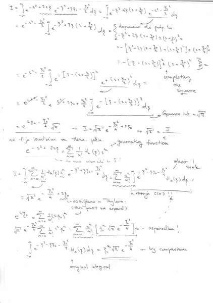

I don't think that will help much. I have solved example scanned (ignore Croatian words :D).
I expand the solution of the integral, and compare it.
  • Handwritten derivation of a Gaussian integral, using completing the square, a generating function for Hermite polynomials, and a Taylor expansion to compare coefficients with the original integral.
Is the expression in your post #3 incorrect? You seem to obtain a different result in your notes.

Oh the notes are not the same problem :) Sorry if I hadn't stated that. In notes function at t=0 is described as oscillator in it's ground state.
By the sums are not the same, I meant that in the notes when I expand the solution which has [tex]e^{\zeta s}[/tex] I can compare it with original integral with generating function in it. Since the generating function is given by:[tex]\exp (2\zeta s-s^2) = \sum_{n=0}^\infty H_n(\zeta) \frac {s^n}{n!}[/tex], putting it back in the original integral:
[tex]\int_{-\infty}^\infty e^{-s^2+2s\zeta}e^{-\zeta^2+\zeta\zeta_0-\frac{\zeta_0^2}{2}}d\zeta=\int_{-\infty}^\infty \sum_{n=0}^\infty\frac{1}{n!}H_n(\zeta)s^n e^{-\zeta^2+\zeta\zeta_0-\frac{\zeta_0^2}{2}}d\zeta=\sum_{n=0}^\infty\frac{1}{n!}s^n\int_{-\infty}^\infty e^{-\zeta^2+\zeta\zeta_0-\frac{\zeta_0^2}{2}} H_n(\zeta)d\zeta[/tex]
Now expanding the solution (expanding the [tex]e^{\zeta s}[/tex] part) and grouping you can compare the integral with the thing in the bracket on the paper.But in my original problem (the one I posted) I get solution from the integral which contains [tex]e^{~s^2}[/tex] terms. If I would expand that I'd get [tex]\sum\frac{s^{2n}}{n!}[/tex] and I cannot compare something that has different terms :\ Plus I mustn't have s parts in the final solution, since it comes from generating function.
I hope I cleared the misunderstanding :)
