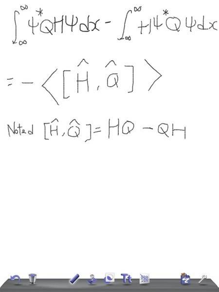

For commutator, HQ-QH = 0 .
But for this case as shown below, complex ψQHψ - HcomplexψQψ= 0?
If the operator Q is in term of (∂/∂t) and (∂/∂x) ,then the HQ-QH may not be zero.
Is there any restriction for Q operator?
  • Handwritten derivation: integral from negative infinity to infinity of psi-star Q H psi dx minus integral of H-star psi-star Q psi dx, equals minus the expectation value of the commutator [H hat, Q hat], with the commutator noted as HQ minus QH.

H is Hamiltonian , Q is an operator
Well, if Q strongly commutes with H, this is enough restriction as it stands. Assuming psi(x) is in an invariant dense everywhere domain, H=f(Q) is a trivial solution of [Q,H]=0.

I think I should ask ,why the H and Q commute each other, how do we know they will commute in general?
The thumbnail I posted is one part for the derivation of ehrenfest's theorem.
What do you mean? H is a function of Q ? Then they will commute?
dextercioby said:
Yes, if H=H(Q) such as e.g. H = Q^2, then [Q^2,Q]=0 on all vectors on which the commutator makes sense.
So whenever I want to use Ehrenfest theorem, the operator H= H(Q), eg Q = momentum. If Q = position then I can't use Ehrenfest because H is not f(x). Correct?
