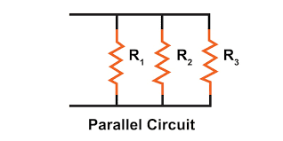

We think of parallel circuits as this:
But what if R1 and R2 is not connected at only two points, but infinitely many points? Were in this thought exercise R1 is not a resistor but a copper bar with a resistance of 5 ohms, and R2 is also a copper bar of 5 ohms? The two bars are placed directly on top of each other, lined up perfectly with each other.

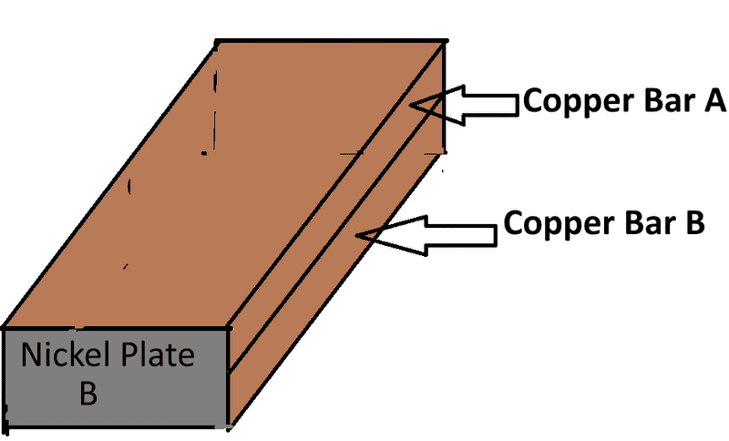

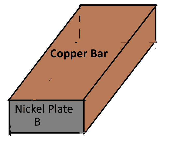

Thanks for the reply. Sorry for not explaining this well.

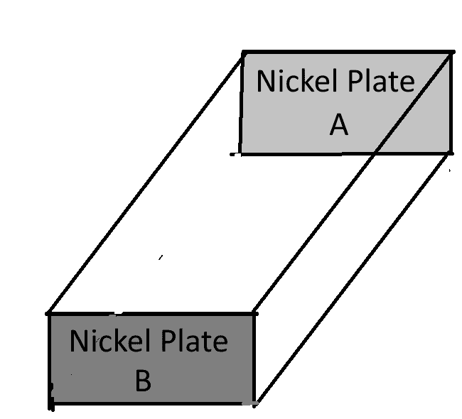

The two rectangles that are 3 inches by 7 inches, are some nickel plates that go to some other part of the circuit. One of these rectangles is at potential A while the other is at potential B. Potential A is so ever slightly higher than the other, because of the resistance of the copper bar.
In between these two rectangles exists my copper bar, that is 11 inches long and 3 inches tall. The two nickel plates have full contact with the two faces of the copper bar.
The Nickel Plate that is at electrical potential A is not visible from this view point sketched above. Only the nickel plate at electrical potential B.
The copper bar has a uniform density and is 10 ohms.
I remove the power source from the circuit and remove the copper bar. Leaving the two nickel plates in place with the rest of the circuit.
I cut the copper bar down the middle perfectly, resulting in two copper bars, each with 5 ohms resistance.
I reassemble the two copper bars so that they are in the same spot in the circuit, one is directly on top of each other, aligned perfectly.
Not shown above because it's blocked out of view, is the nickel plate at potential A.
The two copper bars are in full contact with the two nickel plates.
Are the two copper bars in Series, Parallel or Neither, and how would I determine the resistance? I had assumed that the total resistance would still be 10 ohms for the two copper bars between the two nickel plates. As opposed to the two copper bars are now in parallel so the equivalent resistance is now 5/2 ohms.
Please excuse my poor artwork.
I then had the follow on question that what if Copper Bar A overhangs Copper Bar B by a few millimeters because a human places them on top of each other, and they are not perfectly aligned.
Thanks for help in understanding this, and I hope this is easier to understand and I explained it better. Let me know if I didn't.

Nice thought Exercise !
Now look at the sentence that I have emphasized in bold font. You are absolutely correct there.
However, that means that each of the two identical pieces carries 1/2 of the current for the given voltage source. What does that tell you about the resistance of each piece ?

Only because there is a misunderstanding of the phrase "cut it down the middle".
This was clarified in the next sentence: "One piece is 5 ohms, and so is the other piece."
I believe that @SammyS interpreted the cut to be lengthwise rather than crosswise.

The act of simply cutting it in the middle makes the two pieces in parallel and the resistance of the two pieces is now 5/2 ohms?
I agree.
For your purposes, and the usual introductory approach, it makes no difference, the resistance is still 5/2 Ohms.
Note: If the power source was Radio Frequency (high frequency), there could be a difference, depending on the geometry, the relative proximity and orientation of the pieces, and the frequency. That howeever leads to another whole can of worms. Wait another year or three before you dive in to that!

Thanks for the clarification.
I did mean cutting the bar into two identical pieces in half. Not sure which dimension we are calling length. But I meant this way.

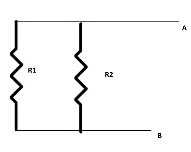

So why are the two pieces considered to be in parallel? I guess I never really got a good definition of parallel.
I always pictured parallel to be this model/picture. Two physically separate paths for current to travel with only two common points.
However this representation/picture is misleading via this thought exercise. The two copper bars act as two separate paths for current to flow. The two copper bars are in contact with each other as they are on top of each other. There is countably infinitely many points in common between the two paths in this thought exercise.

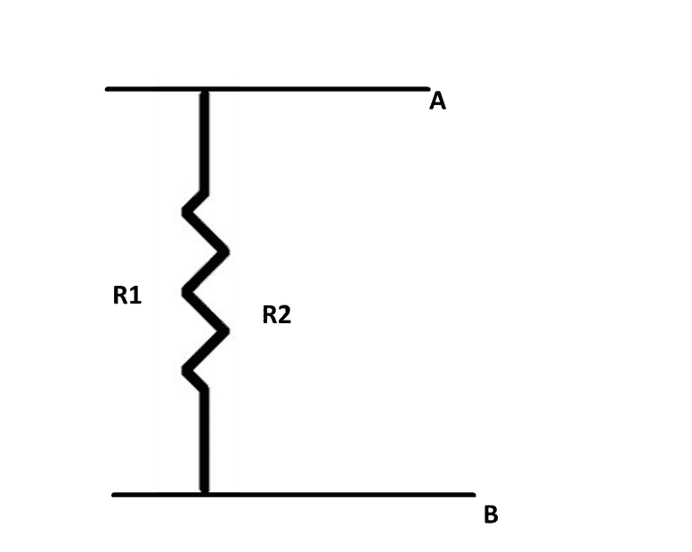

So these two resistors are in parallel
But so are these two. If you imagine the resistor symbol to be slightly thicker, representing one on top of the other, to represent the two copper bars, one placed on top of each other. One surface of one copper bar is in full contact with the other surface of the other copper bar.
Interesting. So the act of simply cutting the bar in half reduces the overall resistance between the two nickel plates. This is a bit perplexing to me. The act of cutting them in half created two separate paths of current to flow. I guess I just thought placing them on top of each other into the original shape would be equivalent to one path as I would have countably infinite common points between the two paths :-p

Yea this is what I meant, and what I assumed.
Cutting the bars in half results in half the resistance = Wrong
But why?
I guess I had just assumed from this equation.
If my cross sectional area is half, than so is my resistance. Why is this wrong?
But I see what your saying, if I have the same voltage A - B.
The current is cut in half in each piece.
So therefore the resistance of each half must be double the initial piece or 20 ohms.
Cutting the original 10 ohm bar in half resulted in each piece having double the resistance of the initial piece.

BuddyBoy said:
Lastly, with the two halves on top of each, assembled in the circuit, each half having 20 ohms, would the overall resistance between the two nickel plates be 40 ohms (ignoring the resistance of the two nickel plates)?
No, for precisely the same reason.

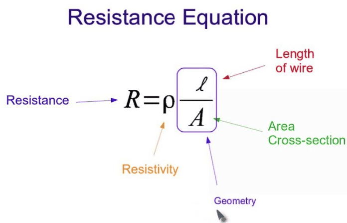

Resistance of a uniform bar is ##R=\frac{\rho L}A##, where ##\rho## is the resistivity, L is the length and A is the cross-sectional area. Splitting in half lengthwise gives two bars of area A/2, so each has resistance 2R. Putting them back together in their original relationship is putting them in parallel, giving resistance ##\frac 1{\frac 1{2R}+\frac 1{2R}}=R##, once again failing to find a fault in the universe.
