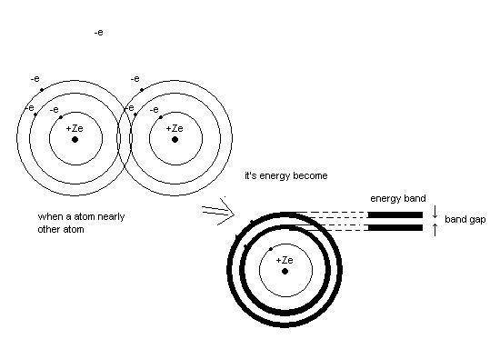

hi !
In a crystal net.When i put 2 or many atom nearly.It's electron's energy will become energy band.(view attached image)
why?
what is a essential of this phenonmenon?
thanks!

When two orbitals interact, you end up with two different orbitals, one which is of lower energy, one which is of higher energy. Look up "bonding" and "anti-bonding" on Google. You can derive the effect with quantum mechanics pretty easily.

First of all, I suggest you to disregard the figure you referred to. It could only makes things more complicated than they really are. In atomic physics, emission/absorption spectra are experimentally obtained using lamps based on gases under low pressure. Low pressure allows to consider single particles as free, i.e. not interacting. For this reason atoms are dealt with as isolated. The electomagnetic spectra result on the allowed transitions between electronic states of the atomic system. Now, the more probable a transition is, the more loud is the intensity for corresondent line you see in the spectrum (I suggest to search Balmer series in google images). This is because every atom in the gas is behaving the same way as long as gas is made of identical particles. This issue is known as the "degeneration" in the gas or, better, in its energy spectrum.

Consider quantum-mechanical problem about a particle (electron) in a potential well (atom). Suppose that you solved this problem and found a discrete spectrum of ehenrgy eigenvalues. Now, consider another problem in which there are two potential wells at some distance. It is not difficult to show that the energy spectrum of this system will be similar to the spectrum of the one-well system. The major difference is that each energy level now splits into two close energy levels. The separation between the two energy levels is determined by the strength of interaction of the electron in the well 1 with the potential created by the well 2. So, the separation increases when the two wells move closer together.
You can repeat the same logic for 3, 4, ..., infinite number of wells. The later case is a model of the crystal. In this model each atomic level has transformed in an infinite set of closely-packed levels, i.e., the energy band.
