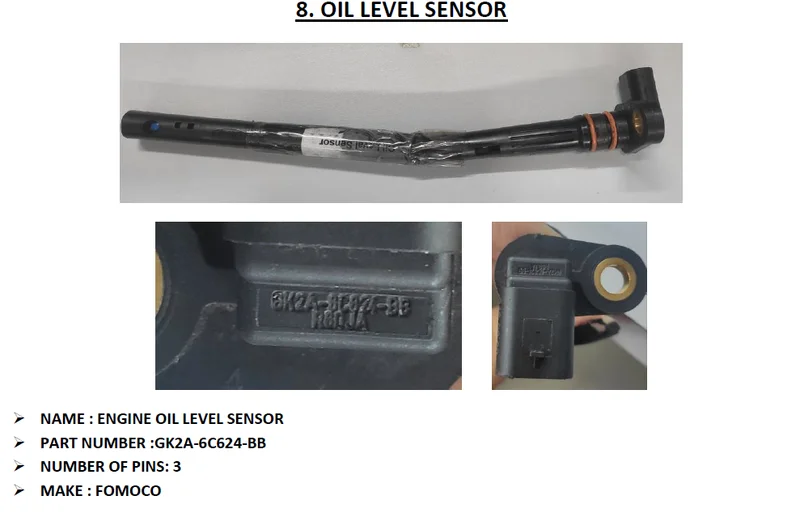

Hello, I am testing a engine oil level sensor. in this i dont know the type of the sensor. and pin descripion.
I initially thought the sensor type was analog. Since i dont know the proper pin information i cant confirm it. Can some of you explain how this sensor works, how to test it. Sensor information i will give below.
Thank you

But i dont have the information of pin details. i tried with different combination. but at one iteration sensor got spoiled. (observed smoke). now i have new sensor. so i want to make sure the pin details first

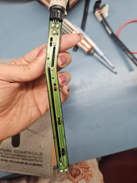

I am also attaching a image of internal pcb structure of oil level

I tried this configuration, but the out put always shows 5v.

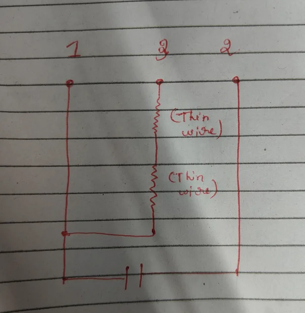

i have just gone through the pcb structure. the routing is look like below image.
