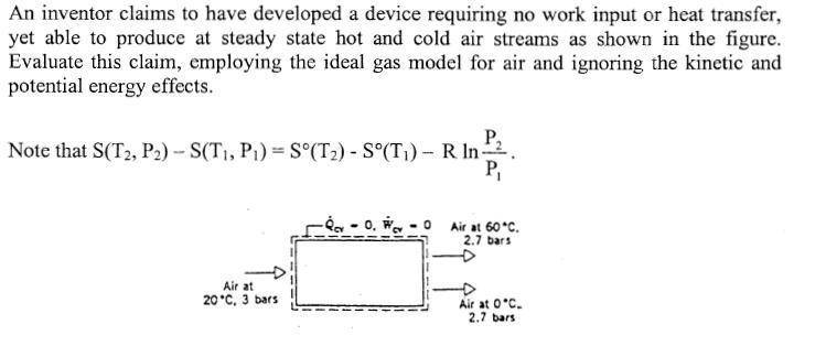

Hi all!
Another problem I don't really know how to solve.
I have the idea to prove that the entropy production would be negative in these cases, but I don't know how to do that...Could anyone please help?
