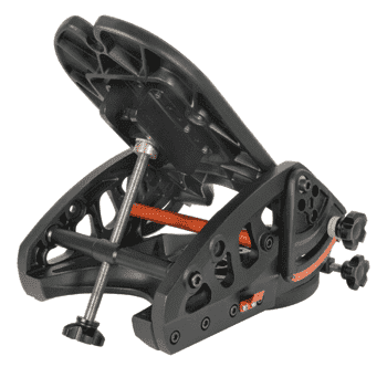

I could do a similar thing with my fork mounted Al/Az mount scope. There are wedge units available to make it an equatorial mount
here's a www pic of the scope I have on its standard mount ...
Black Celestron telescope with a Schmidt-Cassegrain optical tube on a fork mount, sitting on a silver base atop a tripod.
and here's the wedge for it that goes between the base of the mount and the top of the tripod ...
Black plastic equatorial wedge with a metal adjustment rod, orange-accented latitude adjustment knobs and tilt bracket, shown at an angle.
to give the final result of ...
Celestron telescope with a Schmidt-Cassegrain optical tube on a computerized fork mount atop a tripod, shown against a plain light grey background.
