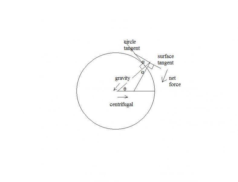

That doesn't look like what I had in mind.
Consider a point at distance r from Earth's centre, at latitude theta. There is a gravitational force towards Earth's centre. Working in terms of pseudo forces, there is a centrifugal force. The resultant of these two forces makes an angle, alpha, to the radial line. Find alpha as a function of r, theta, etc.
Next, the local horizontal (i.e. the surface tangent) must be at right angles to this. Consider a small change ##d\theta## to the latitude. Find dr as a function of that and alpha.
Combining these gives you a differential equation.

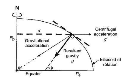

I can't really visualize or understand this as I'm not used to using a rotating frame of reference. So centrifugal force is in the opposite direction of centripetal force right? So if I'm in the same rotating frame of reference, I'm seeing the point being push outwards? The resultant force is the apparent weight?
Because in an inertial frame of reference, the resultant of gravitational force and normal force provide the centripetal force. The apparent weight is the normal force. I'm little confused in the case of a rotating frame of reference.
Yoonique said:

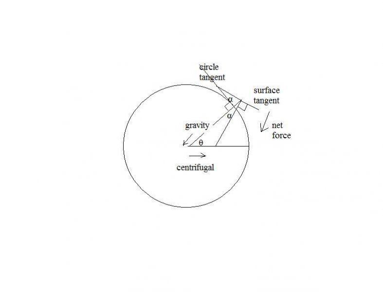

So alpha + theta is 90°?
No.
haruspex said:
Is the resultant force the apparent gravitational force felt?
Yes.
haruspex said:
Yes.
Do I need to approximate anything to find a relationship between α and θ? I can't find a direct relationship ;/
An approximation valid for small alpha would certainly be reasonable.
