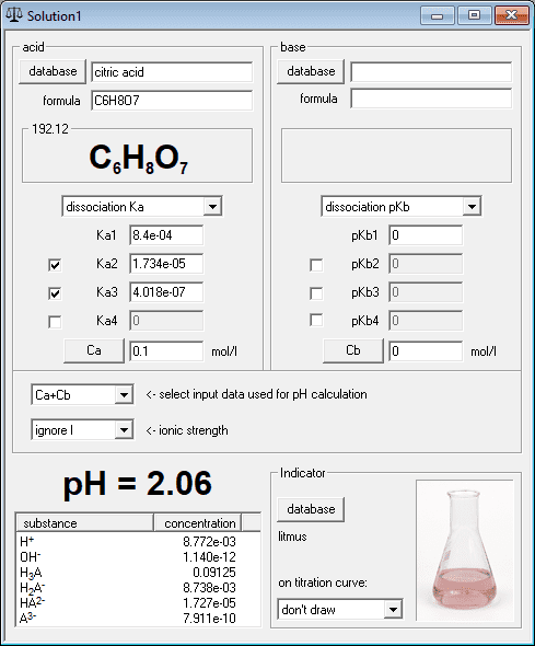

(pKa2 = 4.761, pKa3 = 6.396, by default I am using a bit different value for Ka1, but modified it here to the value from the initial post)
