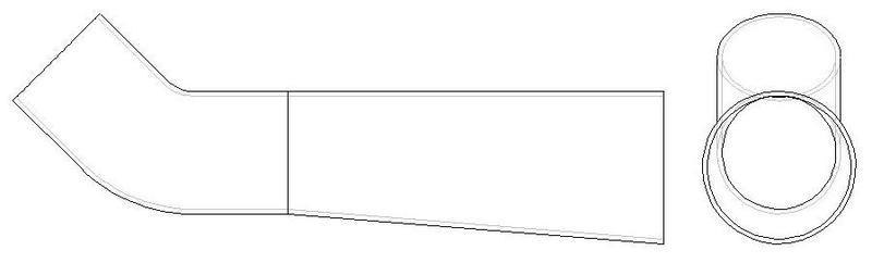

Hi folks,
I have a small problem. In my car I'm building new pipes for the pressurized air. On a straight pipe there is a MAF sensor (Mass Air Flow). It consists of a hot wire and a temperature sensor. After the pipes were redone and the MAF sensor was moved to the pressure side and after the intercooler I experience problems with an uneven signal from the MAF sensor. This is certainly caused by turbulence in the air passing through it as these sensors are very sensitive to that.
This is causing the engine to have problems injecting the correct amount of fuel in low load scenarios causing the engine to run uneven and almost stall in some cases.
So basically I need a way to straighten out the air as easily as possible. Honeycombs usually perform this job well, but I can't imagine gluing a honeycomb to the intake of the MAF sensor can become any good. There is already a steel grid in the intake for correcting minor turbulences.
My idea is welding two plates in the tube before the MAF sensor somewhere. I'm also open for other suggestions. I've made a drawing to illustrate the problem:
[PLAIN]http://img718.imageshack.us/img718/4475/turbulens.jpg
Are you physics folks able to guess what the best solution is? I have really no experience or know any theory about turbulence, so I need some help on this :).
Thanks in advance,
Christian

the trick is to use gentle bends with as large a radius as you can stuff in the engine room..45 degrees is ok but max radius
Based upon recirculation wind tunnel designs, rather than any particular knowledge, I would say the best place to locate the turning vanes would be within the bend.

Yeah, I'm sure it's not that. Because it worked fine when it was at the previous location. But due to new turbo and some stuff, there is no way to have it there anymore. The MAF sensor is also pretty new and the inside looks to be clean.
It isn't possible to use gentler bends than there is now. Before the MAF sensor the intercooler is also causing lots of turbulence, plus the hard bend welded to the intercooler.
Unfortunately that isn't possible due to the bend being a silicone hose. The only way to fix it practically is mounting something in the straight pipe.
After a little though, I think you want to hit the turbulence at close to the source as possible. But why not construct an X-shaped cross-section for the entire length and tack weld it at both ends? It doesn't have to fit snuggly for effect. Vibration considerations may say otherwise.
Yeah, I also think it should be hit as early as possible. But my concern with having a cross section all the way is if there is more air in one of the sections than in the other because of the bend. Then them merging back together before the MAF might also cause turbulence that a straight pipe afterwards would've fixed.
But then again that is my logic :p, could be wrong :).

No, you're right. I didn't want to say too much at once. You would want a full length divider to be a bit leaky. Build-in some leaks with a few half moon cutouts toward the bend end.
So, you don't believe a typical honeycomb laminizer will do the trick or are you concerned with how you'd mount it to/near the MAF?
Not to be too nitpicky, but you can't be "sure" that it's not a MAF issue just because it worked in the past, especially since there has been plenty of modification and relocation. Did you check the voltage (I'm assuming Bosch hot wire style from what you said and playing the numbers) or do you have access to read with a scan tool/software? You stated that this is actually your problem, so I hope you have some data instead of just a hunch.
I certainly don't agree with your idea of the plates (even in theory), especially just fabbing up your own. It's probalby more likely to cause problems than alleviate them.
I doubt there is any need for controlling turbulance anywhere other than at the MAF. Most likely you only need to fix the consistent measurment problem and won't be facing any sort of restriction (when you run out of boost you can start worrying about that).
Mostly concerned how I'd mount it to/near the MAF. As long as the air is evenly distributed in the pipe, then the honeycomb laminizer should do the trick. The MAF relies on evently distributed air by design as it only measures the air flowing in a fraction of the pipe. And ofcourse relies on no turbulence as a good repeatability is absolutely necessary to not cause problems.
Not sure how I would go about securing it. Must be cutting out a honeycomb circle with very tight fit and apply epoxy glue to the wall around it. But the consequences of destroying the honeycomb could be catastrophic. Originally the MAF has a wounded steel net in and out. I could glue it before that, but not sure if that's ideal with the wounded steel net right behind the honeycomb. I guess it would be best with just the honeycomb.

I will agree with Phrak. Why can't you just put 4 or 5 tubes of a smaller diameter in your silicone bend?
Also, here is another design for your system that, I think, would help you. It consists of a constant diameter bend followed by a tapered pipe (note that the taper of the pipe is tangent with the "inside" of the bend):
It might be too complicate (or costly) for you to modify your system, but it might give new ideas.
