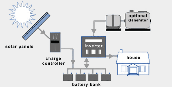

So i live in Lebanon, and since a long time now we have constant power cuts, almost half the day each day. For that the Lebanese made up a system in which each neighborhood has power generators providing electricity to the residents when the power is out. Usually the owners of these generators would charge an average of 100$/month for a 5A/220V AC subscription. You'd have circuit breakers on the street for 5A or 10A depending on the subscription, so it doesn't matter how much energy you use, you will have to pay the same, usually i use 2.5A on average and the excess energy goes as extra profit for the owner of the generator. My question is, how would it be possible to use the remainder of the 5A perhaps to store the energy when not needed and then when energy is needed to go beyond the 5A limitation.

Perhaps you would benefit from something called an off-grid inverter. Charge the batteries when the gird is up, switch over to the off-grid inverter when it's down. I haven't researched them enough to know if they will meet you need, but it's something you might want to look into although I think it's pretty expensive.
http://energyinformative.org/grid-tied-off-grid-and-hybrid-solar-systems/
Here is something else that might interest you.
http://electronics.stackexchange.co...esel-generator-with-a-pure-sine-wave-inverter

@A Chamas -- You will only be able to run your major appliances when the AC Mains power is on. It is impractical for you to store enough energy to run them when the AC Mains power is off. You can charge 12V batteries when the AC Mains power is on, and use that 12V battery power later for small loads like a fan and a reading light and a radio and small portable TV. You could also add a solar panel and 12V power converter to help you when the power is out and the sunshine is strong.
