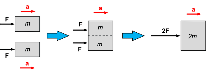

Imagine single force ##\mathbf F## acting on mass ##m## on a frictionless surface. Let ##\mathbf a## be the acceleration of the mass. Now look at the figure below.
The figure on the left shows a bird's eye view of two such identical masses being acted upon by identical forces ##\mathbf F##. They have identical accelerations ##\mathbf a## and are started from rest at the same time.
Since the accelerations of the two masses are the same, they move as one. This means that they can be glued together and nothing changes. This is shown in the figure below, middle.
Well, what do we have here? It is shown in the figure below, right. We have mass ##2m## acted upon by total force ##2\mathbf F## having acceleration ##\mathbf a.## Clearly, for constant acceleration, if one doubles the mass one has to double the net force. In terms of an equation $$\mathbf a=\frac{\mathbf F_{\text{net}}}{m}.$$

hi, thank you! This makes a lot of sense.
