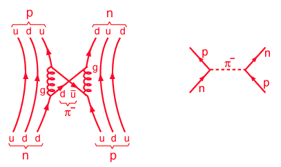

Let me start off by saying that I am no professor of any kind, i am simply a high school student in way over his head concerning particle interactions. Without a class to teach me, i have used the magic of the internet to attempt to get a rudimentary understanding of these interactions. I understand (somewhat) color charge and how it works, how the gluons facilitate the color change. I understand that in simplified terms, the strong interaction between hadrons is like excess color force from inside the particle. What i don't understand is how pions facilitate this force, for all i know i have this all wrong. the information I am trying to understand came from this picture. Any help by explaining this picture would be great, preferably in layman's terms with as little math as possible.
Are you familiar with the idea that an electron and a positron can combine to become a photon, or the reverse process, that a photon can turn into an electron and a positron? Something similar applies to gluons: a gluon can split into a quark and an antiquark, or a quark and an antiquark can combine into a gluon.
If we just focus on the neutron in the left diagram, starting from the bottom (time goes upwards), what happens is that one of the down quarks emits a gluon, and the gluon splits into an up quark and an up antiquark. The down quark and the up antiquark combine to make a pion, which leaves, and the new up quark takes the place of the original down quark. But now that makes the overall particle a proton, rather than a neutron.
Meanwhile, the pion travels across to the proton, the up antiquark in the pion annihilates with one of the up quarks in the proton, creating a gluon which is then absorbed, and the down quark that came across in the pion takes the place of the annihilated up quark; so now the proton (up up down) has become a neutron (down up down).
Along the way (while traveling between neutron and proton), the pion was held together by gluon exchange between down quark and up antiquark.
Aah, okay, the role of the pion makes a lot more sense now, thanks so much for clearing up the meaning of the diagram. Of course, as understanding does, now i just have so many questions...
where does the actual force holding them together come from? Is it simply the fact that there is a constant equilibrium and exchange of particles?
And also, I was a bit confused when you talked about Gluons splitting, I was pretty sure that they were elementary and therefore had no component parts. Then i read about Gluons interacting with one another, forming "virtual quark-antiquark pairs". I somewhat grasp the concept after reading through things concerning Hawking Radiation and how the "imaginary" universe is the one that makes sense mathmatically, But is there a process to generating these pairs...? is it the same as in Hawking Radiation, pulling the pairs out of the vacuum...?
