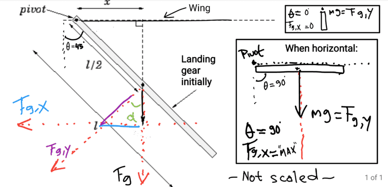

Imagine an aircraft of which the its wing is connected to its landing gear by means of a hinge (joint), and then the gear suddenly gets stuck midway. If, subsequently, the aircraft makes a turn around its longitudinal axis (see picture), it seems to hold true that then the angle between the objects is likely to change. The question is “How does rotation of an aircraft around its longitudinal axis influence the angle between the wing and a landing gear that is stuck; rotation in which direction will make the gear get extended?”
I have brainstormed about how to solve it and those are my ideas:
Option A) Visualize a free body diagram and ask yourself which forces are acting on the gear and how their magnitude and direction can be changed in such a way that the gear gets extended to the left. There is a x and y component of the gravity force working on the gear. And then (conceptually) figuring out what happens with those components when the airplane tilts to the left and right, in order to answer what happens with the angle.
Option B) Seeing the question as a torque/moment question and, therefore, answering “How does the clockwise and anti-clockwise rotation of an aircraft around its longitudinal axis change the angle between the wing and a landing gear that is stuck?”
Option C) A combination of both option A and B.
I would really appreciate it if I could be told how to go further or can be provided sources. Please keep in mind that I am a beginner in this area.

Here an illustration as addition to my question to make it more clear.

Not really sure I understand the question. But I'm assuming:
1. Your idea of how to get the gear unstuck is to rotate the aircraft in such a way that the weight of the gear will help bring it down.
2. You're rotating ONLY about its longitudinal axis. Of course generally when an airplane turns about it's longitudinal axis it will also turn about its vertical axis as the lift vector is now pointing off to the side causing the nose to point a different direction. However a pilot can counteract this by using opposite rudder (this is called a side-slip). But for simplicity sake you're only considering rotation about the longitudinal axis.
3. You're not taking into the account the drag forces on the plane or gear or anything.
In this case I would say that turning the plane such that the landing gear becomes more horizontal would cause a higher bending moment on the linkage, which would help un-stuck the gear, so in your diagram above, turning right (from the pilot perspective) would do it.
I think you're on the right track. Basically simplify it: Pretend you're holding a rod with a weight on the end. If you held it vertically there would be no bending moment on your hand. If you held it horizontally that would be the worst case. The bending moment on your hand would be the mass x gravitation acceleration x the horizontal distance the center of gravity is away from your hand. So what changes when you rotate it from vertical to horizontal? Only the horizontal distance the c.o.g. is from your hand. Find the relationship between the angle and the distance and you've solved your homework problem. :)

First and foremost, really thanks a lot everybody for providing me this awesome wide spectrum of ways on how to deal with this problem. As being someone in preparation for applying to a pilot trainee program, I am always curious about every detail. Especially, the fact that you are providing terminology (such as banked G maneuvers) helps me a lot.
@brianrtw The question that I put forward is (indeed) exceptionally featuring two fairly standard answers, namely: “a bank to the left” and “a bank to the right. Thus, all your assumptions are totally right.
It seems to me that the concept of “bending moments” is enough for answering this particular question. Besides, I am pretty sure that being informed about the “banked G maneuvers” is absolutely of great value for solving more complex versions of the question. So, thanks a lot for that.
I am going to draw a free body diagram to experiment with bending moments on stuck undercarriage and return my conclusions and see if one would be so kind to check if I am on the right way.

With regard to the same question, I concluded the following:
When the bank angle in a rightward turn increases, the stuck undercarriage will make a wider angle with the work line of the gravitational force. I assume that, the wider this angle, the bigger the X component of the gravitational force, and thus, the more movement the gravitational force is likely to bring about in the X direction.
I have drawn one complete FBD and a simplified torque illustration.
I wonder if my simplified illustration - in which I represent Fgx as the perpendicular distance from the WHEEL of the undercarriage to the work line of the gravitational force - is a proper method (??) for answering my topic question. It seems way more time efficient compared to drawing the entire FBD. By choosing that method I will have neglected the c.g. of the undercarriage and seen the WHEEL as the point where the gravitational force applies. When making torque calculations, it should be OK to do so, right.. or not?
Curious about your valuable opinions. Thanks a lot in advance!

The bank angle will increase the torque produced by the weight of the landing gear but...
If the undercarriage leg was made horizontal by banking (without turning) then the torque would be mgl/2. However if you bank and pull 3g in the turn the torque would be roughly three times that at 3mgl/2. So I would suggest that pulling a high g turn is quite a bit more effective than "just" banking.
I say "roughly" because the centripetal force won't be quite in the same direction.
