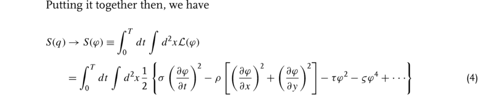

Hi, could someone please explain where the tau and sigma terms come from in this expression:
I see the kinetic energy and quadratic "mattress" potential terms, but the tau and sigma kinda come out of nowhere. Where are they from?
These are just arbitrary coupling constants. They originate from the self interaction energy V of the field ##\varphi## with itself in equation (2). It is a way of expressing the self interaction part of the arbitrary function V in a series of ##\varphi##.
Thanks that makes sense.
