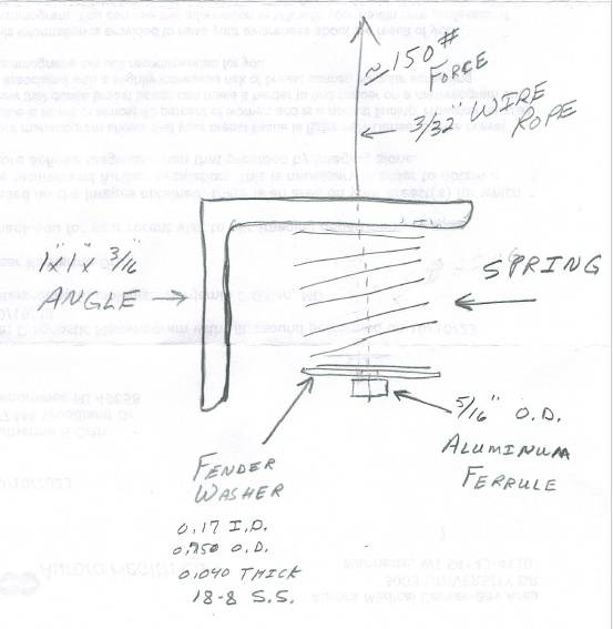

Please see the included sketch. I need to know if the fender washer I'm planning to use will be strong enough to not deform and thus reduce the tension on the wire rope. TIA, Dave

Failure of the washer will depend on the unspecified inside diameter of the helical spring.
Yes, forgot to include the spring info. Spring I.D, is 0.488 and the O.D. is 0.812. I should also mention that the aluminum ferruel will not have full contact with the fender washer due to distortion as a result of crimping it to the wire rope. Thanks.
Only the 0.095" wire centres the washer in the ID=0.488" spring.
For that reason, it is likely that the wire will not remain axial in the spring.
I am not saying the washer will fail, just that it will not constrain the position and alignment, to prevent buckling sideways of the spring.
I've considered that and am thinking about adding a sleeve to insert between the wire rope and the spring ID.
Washer annulus = ( 0.75 - 0.17 ) / 2 = 0.29"
Wire diameter = 0.095"
Sum of wire and annulus = 0.095 + 0.290 = 0.385"
That is less than the spring ID = 0.488"
So the washer can be pulled through the inside of the helical spring.

You probably have guessed by now that I'm a DIYer and not an engineer. That being said, I do understand what you are suggesting is a possibility. Thus my original question...will the fender washer be stiff enough to maintain the load that it will see?

If it isn't, just use 2 or 3 of them.

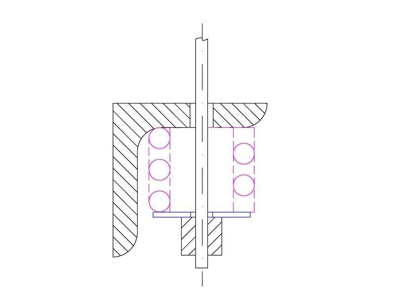

I have created a scale drawing with the dimensions that you have provided.
Note how the magenta spring is free to move toward the right and go over the outside diameter of your washer.
At a glance, that washer is the only member of your assembly that looks marginally able to match the other beefy elements.

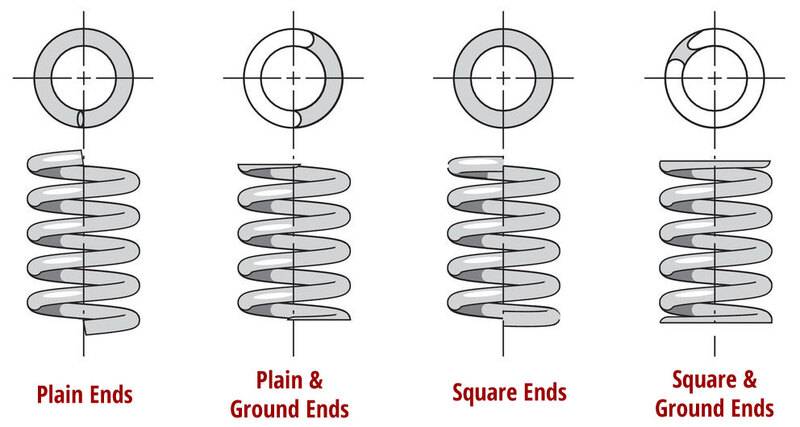

Another factor that may make things worse is the non-flat bottom of that heavy duty spring (if the spiral ends have not been squared and ground to be flat), which will transfer the load completely off-center to the washer, which will not remain horizontal.

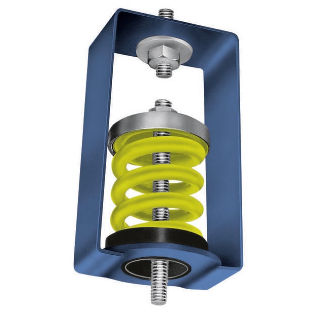

Note how commercial spring hangers, rather than flat washers, have spring cups at both ends of the spring, in order to avoid the discussed problem.
As you don't have those metal cups, a simple rubber sleeve located inside the spring, having the proper OD and ID, could greatly help with stability.

Thank you for your time and thoughts. The springs are plain and ground ends. I agree that installing a sleeve between the wire rope and the spring I.D. will add stability. All I want to do is to maintain tension on the wire rope and the spring is there to compensate for slight movement of the surrounding/supporting structure (treated wood). I'll continue looking for washers that may be a bit thicker. Thanks again!!
