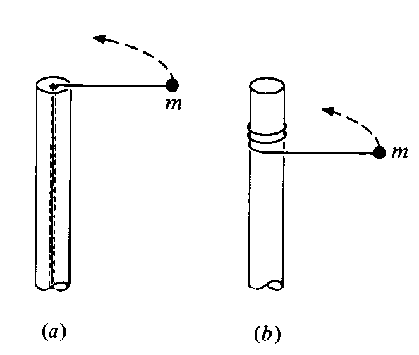

A) Assuming no gravity
The only external force acting on the mass m is tension and the torque due to it about the axis of post is 0.
Hence, applying conservation of angular momentum about the axis of post gives,
## m v_0 r = m v R
\\ v = v_0 r/R ##
B)The only external force acting on the mass m is tension and the torque due to it about the axis of post is RT ##\hat z##.
I can't say the conserved quantity in advance.
Taking ##\theta ## to be the polar angle,
## r(\theta ) = r_i - R \theta ##
Work energy theorem tells us that net work done on it = change in kinetic energy
## W = \int _{\theta _i} ^{ \theta _f} RTd\, \theta##
## \vec a = (\ddot r - r {\dot \theta}^2 ) \hat r + (2 \dot r \dot \theta + r \ddot \theta ) \hat \theta ##
## T = m (\ddot r - r {\dot \theta}^2 )##
Is this correct so far?
In case (b), what is preventing the post from spinning? The tension is always tangent to the radius of the post.
I will assume the post is fixed in the ground, so cannot rotate. (Equivalently, let the post be free but take the limit of large post-mass.) Otherwise we need to know the mass of the post, and also there would be a question of if the mass ever hits the post (for small post-mass I would think not). @scottdave

So if we take these strings to be inextensible, can the mass move along the direction of the rope (and therefore the direction of tension) in part (b)? What about in part (a)? What are the implications?
Since gravity acts vertically and you are using angular momentum about a vertical axis, you do not need that assumption here. You do need it in B).
Good start... is anything doing work on it?

Angular momentum is a vector. If there is no torque about the vertical axis, how can the component of angular momentum about the vertical axis change?
I am not claming the entire vector is conserved.

Can anyone please tell me how to number an eqn. in PF?Another attempt:
Using cylindrical coordinate - system, taking axis of post as z- axis and origin at the bottom of the post, and denoting by the position vector of mass m by ##\vec x,##
## \vec x = R \hat s + r \hat \phi + \vec z ##
## \dot{ \vec x} ## ##= ( R \dot \phi + \dot r ) \hat \phi ## ## - r \dot \phi \hat s + \dot {\vec z} ##
So, taking the above advice, component of velocity in ## \hat \phi ## is 0.
This gives ## \dot \phi = \frac {-\dot r } {R}##
## \vec F_{net} = mg (- \hat z) + T(\hat \phi)##
Can't I simplify the problem by taking no motion in ##\hat z ## direction?

Assuming no gravity,
Torque acting on the system, ## \vec \tau = RT \hat z ##
Angular displacement of the mass m is denoted by: ## d \vec \phi _s##
Now, I have to express ## d \vec \phi_s ## in terms of ## \phi ## and other known quantities and then to use work energy theorem.
Let's take ## \theta ' ## as the angle between ## \hat s ## and ## \hat s_m ## (it corresponds to the polar unit vector of mass m ).
Then ## \phi_s = \phi + \theta ' ##
No need to do any further calculation.
If I consider no motion in the ## \hat z## direction, then there is no component of ##d \vec \phi_s ## in ##\hat z ## direction as ## \hat \phi _s ## could be expressed in ## \hat \phi ## and ## \hat s## unit vectors and so is ## d \vec \phi_s ##.
Now, since ##d \vec \phi_s ## is perpendicular to ## \hat z ## , work done by torque is 0.
Since, there is no work being done on the mass, the work energy theorem says that its kinetic energy remains constant.
So, the speed ##v(t) = v_0## remains unchanged.

You did not answer my question regarding B) in post #4. If you answer it correctly you will find this case is quite easy.

I'll come at it a diffent way: If the string is doing work on the mass, where is it getting the energy from?
Yes, now I understood the question and the answer both.
Consider the string to be in-extensible, the body is not moving the direction of tension force. Assuming there is no motion in the vertical direction, work done by gravitational force is also 0.
In this case, net work done on the mass = sum of the work done by each force = sum of the work done by torque due to each force= 0
Now, by work energy theorem, kinetic energy remains unchanged and so is the speed.
