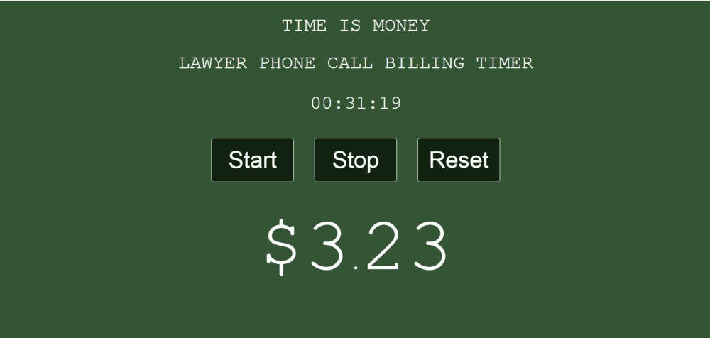

Just for fun, here's something a little more elaborate that I threw together for a gal who was spending too much billable time on the phone with her lawyer, talking about whatever instead of focusing on her legal concerns:

Here's a screenshot:
Line 103 sets the per-second rate at 10.42 cents, which comes out to the lawyer's billing rate of 375/hr (+ 12 cents due to rounding the seconds to the nearest hundredth) ##-## I view that as too much to pay for 'girl talk' when you're not especially wealthy . . .
