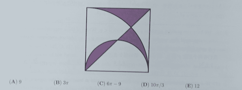

Find area of the shaded part in the given diagram

See attached.
O level Math

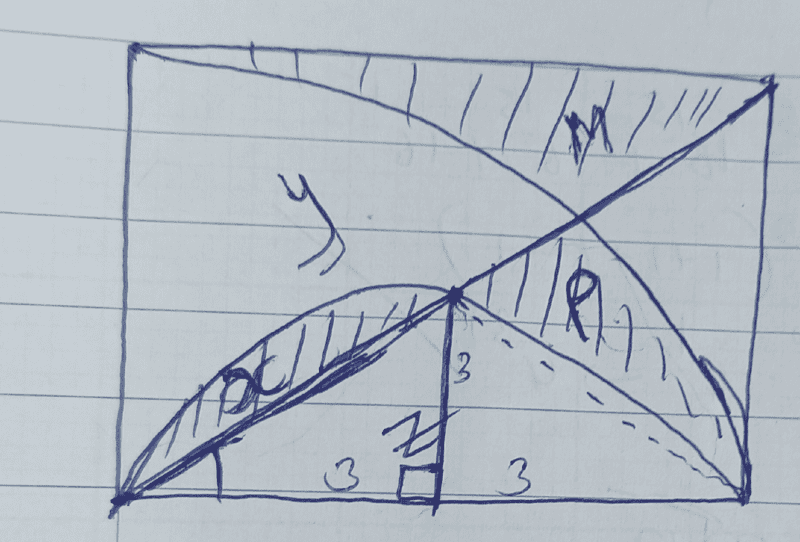

In my working, i have the following approach;
Using area of semi -circle and area of sector concept;
##x +z = \dfrac{9π}{2}##
##x +y = \dfrac{9π}{2}##
##z+p = \dfrac{9π}{2}##
On solving the simultaneous equations,
##⇒x=p##
then,
##x=\dfrac {9π}{4} - \left(\dfrac{1}{2} ×3 ×3\right) = \dfrac{9π-18}{4}##
##⇒ p = \dfrac{9π-18}{4}##
Therefore,
##m+x+p = \dfrac{36-9π}{2} + \dfrac{9π-18}{4} + \dfrac{9π-18}{4}##
##=\dfrac{36-9π}{2} +2\left( \dfrac{9π-18}{4} \right)##
##=\left(\dfrac{36}{2} - 4 .5π+ 4 .5π - 9 \right)= 18-9=9##
Unless there is a better approach. Good day and cheers.

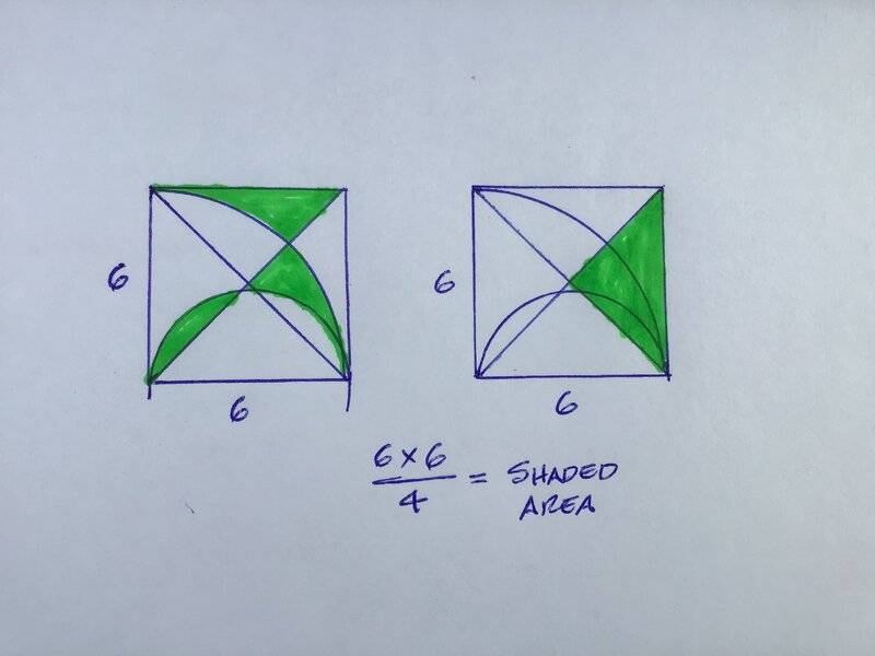

Using symmetry of the individual shaded areas respect to the diagonal lines may be a simpler solution.

An alternative approach:
x=x'
m=m'
So, the area is the triangle on the right, i.e., quarter of the square.
EDIT: x-posted with #2.
