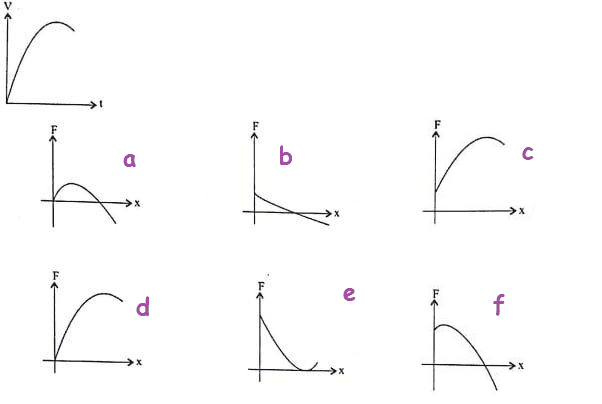

Find force as a function of position: F=F(x) using v=v(t)
6 replies · 1K views
MatinSAR
673
207
We have v-t graph of a moving object. We are asked to guess it's F-x graph.
##\vec F=md \vec v/dt ##
If we consider ##v=-3t^2## then: $$x=-t^3$$$$a=-6t$$
Using ##t=-x^{1/3}## we have : ##a=-6(-x^{1/3})=6x^{1/3}##. My answer suggust that ##F=Ax^{1/3}## but in options we have ##F=-Ax^{1/3}##.
Can someone guide me where my mistake is?
on Phys.org
My 2nd idea:
Forget about the formulas and math ...
This object has positive velocity so when "t" is increasing "x" is also increasing. We know that before ##t=t_0## the acceleration is posotive but it's magnitude is decreasing with time so it is decreasing with position also.
After ##t=t_0## the acceleration becomes negative and it's magnitude is increasing by time and by position.
So "b" is the correct option.

MatinSAR said:
Homework Statement: We have v-t graph of a moving object. We are asked to guess it's F-x graph.
Relevant Equations: ##\vec F=md \vec v/dt ##
I think the mistake was to consider ## v = -3t^2##. If you are saying ##v## is an inverted parabola, then its graph would be like: ##v = -pt ( t-q)##. Two distinct roots (one zero), not a single repeated root (both zero)

Think about when the acceleration (force) is positive, zero or negative.
Think about what the velocity always being positive means for the position.

MatinSAR said:
Did you see post #2?
Missed it. Sorry. You did what I suggested before I suggested it.
BTW, the mistake with -3t2 is that it is always negative.

Thank you for your time. I see that big mistake in my first approach now.
