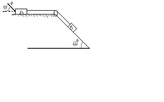

Two rectangular blocks of weight, A = 150 N and B = 100N are connected by a string and rest on an inclined plane and on a horizontal surface as shown in the figure. The coefficient of friction for all contiguous surfaces is [tex]\mu[/tex] = 0.2. Find the magnitude and direction of the least force P at which the motion of the block will impend.
frictional force = [tex]\mu[/tex]. N
where N = normal rection
I had calculated T In the string from box A and then I have made two equations from box B. The only think I am unable to find is the angle [tex]\theta[/tex]. Somebody help me to find that angle.
Answer: P = 161.7 N and [tex]\theta[/tex] = 11.31 degree

Well what two equations did you get?
Hard to show me in the diagram but I know you all can understand cause you all are very well known to such resolution of forces. So I'm proceeding directly without any diagram.
For body A
N = 150 cos 60 = 75 N
T =[tex]\mu[/tex] N + 150 sin 60
= 145 N
For body B
R + P sin[tex]\theta[/tex] = 100 ......(i)
[tex]\mu[/tex] R + 145 = P cos[tex]\theta[/tex]
= 0.2 R - P cos[tex]\theta[/tex] = -145 ...(ii)
Now I can solve this two equations and can calculate the value of P if I know value of [tex]\theta[/tex]. I want your help.

hi snshusat161! :smile:
(have a mu: µ and a theta: θ :wink:)
subtitute for R from (i) into (ii), and your equation should be of the form P(Acosθ + Bsinθ) = C …
now write Acosθ + Bsinθ as a multiple of cos(θ+φ), for some φ :smile:

then I will have 1.01P Cos ([tex]\theta[/tex] - 78.96) = 165
and still i have two unknowns and only one equation. :confused:
that 60 degree is not the value of [tex]\theta[/tex]. It is unclear in diagram but [tex]\theta[/tex] is the angle made by force P on the horizontal. (block A).

Sorry, I made a mistake here.
Here's the correct one
For body B
= 145 N
For body A

(what happened to that θ i gave you? :confused:)
ok, if that was the correct equation, what it would tell you?
it says that you can get the desired motion for different values of θ, and for each value of θ there's only one value of P …
but for what value of θ is that value of P a minimum? :smile:
sorry it was sine not cosine. so p will be minimum for max value of sine. i.e theta minus phi is equal to ninety. thanks tiny tim you really explained me in a very interesting nice and smart way.
i am on phone so I'm inclined to use texting language. please ignore if you feel that my posts are breaking any rules.
