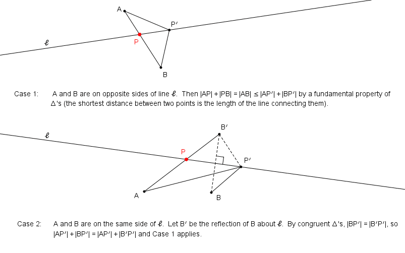

Find a point $P$ on the line $3x+2y+10=0$ such that $PA+PB$ is minimum given that $A$ is
$(4,2)$ and $B$ is $(2,4)$
My Try:
Let Coordinate of point $P$ be $(x,y)$. Then $PA = \sqrt{(x-4)^2+(y-2)^2}$ and $PB = \sqrt{(x-2)^2+(y-4)^2}$
Now Let $f(x,y) = \sqrt{(x-4)^2+(y-2)^2}+\sqrt{(x-2)^2+(y-4)^2}$
Now How can i Minimize $f(x,y)$
Help me
Thanks

This is best solved using Euclidean geometry.
Let $l$ be a given line and $A$ and $B$ be two points given on the plane.We need to find a point $P$ on the line $l$ such that $|PA|+|PB|$ is minimum.
If $A$ and $B$ are on different sides of the line $l$, then simply join $A$ and $B$ by a straight line $m$ and the point of intersection of $l$ with $m$ is the required point $P$.
If $A$ and $B$ are on different sides of the line $l$ then reflect $B$ about the line $l$.Say $B'$ is the reflection of $B$ about $l$.Join $A$ and $B'$ through a straight line $m'$. The point of intersection of $m'$ with $l$ is the required point $P$.
If you need a justification why the above works you can ask me but I suggest you try justifying it yourself first. It is not hard. You simply need to make use of the fact that the shortest path between two points on the Euclidean plane is through the straight line passing through the points.

Here's a diagram to go with caffeinemachine's excellent solution:
