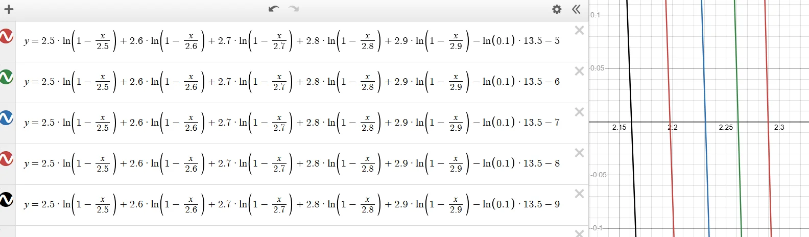

We should solve the equation of ##\lambda##
$$\sum_{j=1}^n c_j\ln(1-\frac{1}{c_j \lambda}) - \ln s \sum_{j=1}^n c_j - V_f=0$$
N's are given by solution ##\lambda## as
$$ N_j=\frac{1}{s}(1-\frac{1}{c_j \lambda}) $$
We can draw the graph of LHS, ##y=f(\lambda)## by computer to observe whereabout y=0. If we can expect $$ \frac{1}{c_j \lambda} << 1 $$ for all j, ##\lambda_0## satisfying
$$-\frac{n}{\lambda_0}- \ln s \sum_{j=1}^n c_j - V_f=0$$
is a good initial point for numerical methods.
[EDIT] I corrected careless mistakes.

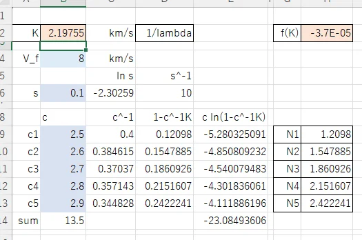

Thanks for the comment. I should appreciate it if you share values of setting parameters : ##c_j##'s , s and ##V_f ##. I would like to go to physics from mathematics.
the ##c_i##'s and ##V_f## will be variable but the ##c_i##'s will typically be around ##2400-3000ms^{-1}## and ##V_f## will be anywhere from ##2600 - 9000ms^{-1}##
Thanks. How about s ?

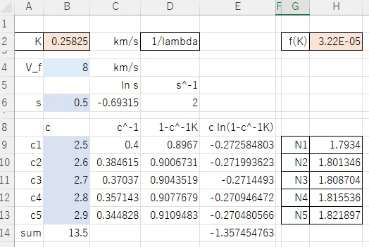

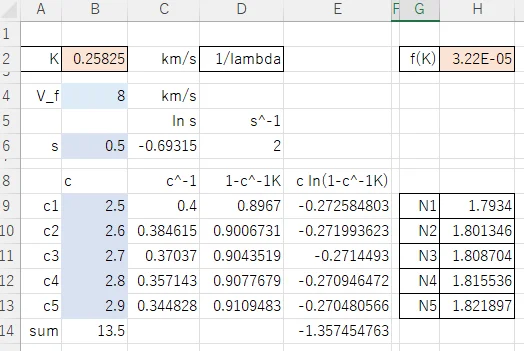

Say s=0.5, please find attached my calculation in EXCEL sheet where I try inputting ##K=\frac{1}{\lambda}## so that f(K) becomes around zero.
Is N>1 OK ? Does these results have a sense of physics?

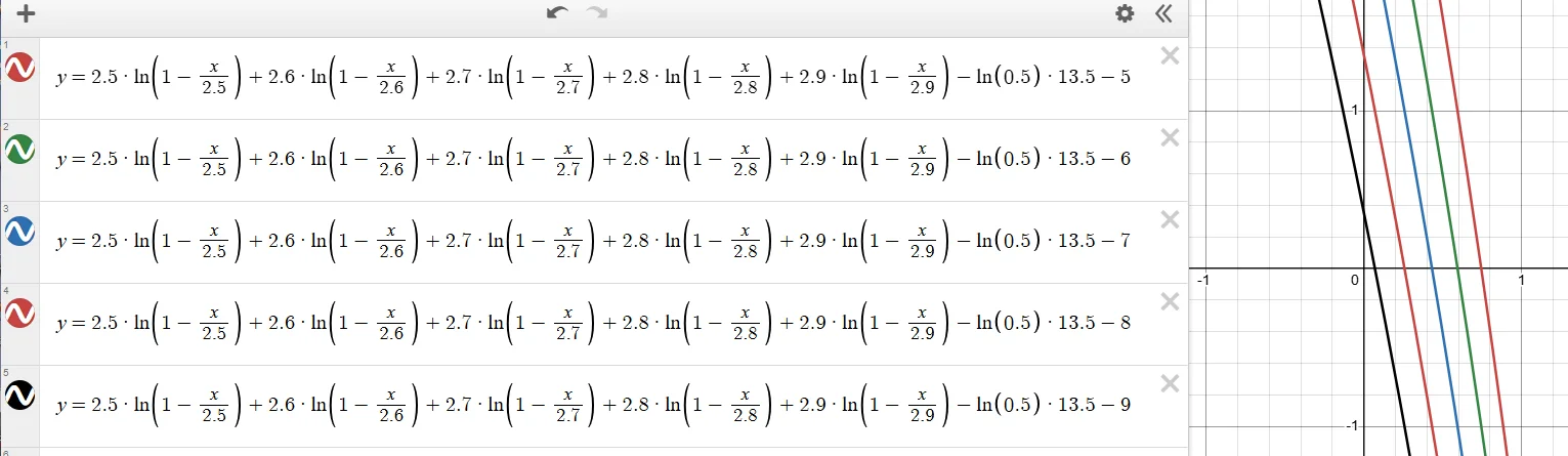

Some graphs of y=f(x) for variation of v_f.
For s=0.1

s will be around 0.1. These results make sense but this is a solved issue currently.
