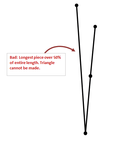

I thought I would share the logic I used to solve this problem with some pictures.
edit: By the way, this is by no means intended to be a proof, or particularly rigorous, just an illustration of the thought process I used.
First I will show why the longest piece of the 3 segments needs to be less than half the total length in order for a triangle to be possible. Imagine the circles attached at each end of the segments (in figure 1 below) can act as points of rotation. I think it quickly becomes clear from looking at the diagram that one cannot arrange the 3 segments below into a triangle due to one of the segments being greater than half the total length.
Figure 1.
