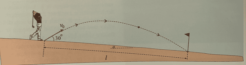

A golfer attempts an "hole in one" by launching the ball at an initial velocity ##v_0##, making a ##30^\circ## angle with the golf course. The golf course makes an angle ##\alpha## with the horizontal. Find the initial velocity of the ball, given that the distance to the hole along the golf course is ##l##. Find numerical values for ##v_0##, if ##l=20m## and ##\alpha = 10^\circ##
\sum \vec F = m\vec a
Hello! Hope I got this right. Completely new around here.
The image that goes along with the problem is:
Diagram of a golfer on a sloped hillside hitting a ball with initial velocity v0 at a 30 degree angle, the dashed parabolic trajectory landing near a flag, with incline angle alpha and slope length l marked.

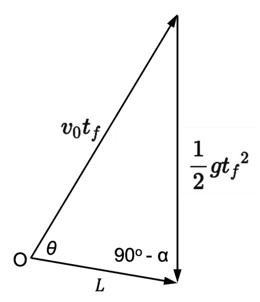

Vector addition triangle with vertex O at lower left; a long arrow labelled v0 tf goes up and to the right, a vertical arrow labelled one half g tf squared points straight down, and a horizontal-ish base L closes the triangle, with angle theta at O and angle 90 degrees minus alpha at the lower right.
Problems of this sort can be solved quite easily if you write the displacement vector ##\mathbf L## as the sum of two vectors and draw the vector addition diagram (see right) $$\mathbf L=\mathbf v_0~t_{\!f}-\frac{1}{2}\mathbf g t_{\!f}^2.$$ Two of the three angles in the ensuing triangle are given and the third can be trivially found. Then one can apply the rule of sines to get two equations and two unknowns, ##v_0## and the time of flight ##t_{\!f}##.
(Edited to fix typo in the vector equation.)
