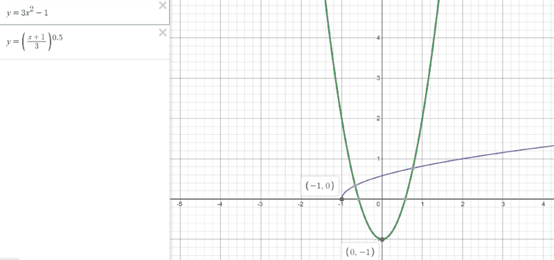

i got ##x≥-1##
but the textbook indicates the solution as ##x≥0## hmmmmm i think, that's not correct...

...I think i see why..." a function qualifies to have an inverse if its only ##1-1## or many to one ...but not one to many...we have to restrict the domain in order to realize a function lol :cool:
I think a "many to one" function can’t have an inverse over its whole domain. In fact that’s why your original function, y = f(x) = 3x² -1, only has an inverse over part of its domain.
f(x) = 3x² -1 is many-to-one. For example, both x = 1 and x = -1 gives the same value of y = 3x² – 1 = 2.
So, if we are given y = 2, we can’t ‘get back’ to a unique value for x.
In this question, by limiting the original function’s domain to x≥0, we restrict the function so now it is one-to-one and the inverse function exists.
(But that’s a non-mathematician’s view.)
That's correct, an inverse would suffice if we restrict the domain...in general, for quadratics this would be determined by the ##x## co- ordinate value at the turning point of the graph.
