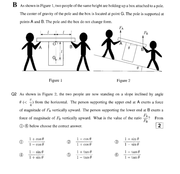

what's the Fa and Fb?

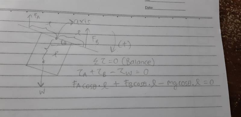

my logic is
Fa = Wa - N = mg - ##\frac{N}{\cos \theta}##
so is Fb...
so the ratio is 1. But I know it's wrong. What will make the difference between Fa and Fb?
can anyone give a clue please?

Clearly FA + FB = W. To find what fraction of W is each force you need another equation. Consider the sum of torques acting on the box.

My logic is there are 3 torques
Torque at A
Normal force*L (clockwise)
Torque at B
Normal force*L (counter clockwise)
Torque for W
mg cos thetha*L
FA + FB = W.
What should i do next?
Is the w do torque?
Is it necessary to find the w torque? Is the length for W torque is L?

Pointing up. Perpendicular to ground. And parallel to W.I am confused to choose which point as point load for the W.

The mass centre is shown as point G.

If your origin is as indicated by the arrow in your drawing then
(a) The signs of the torques are inconsistent with one another. Follow whatever convention you wish, but torques that tend to rotate the box in the same direction must have the same algebraic sign. Torques do not necessarily have positive or negative signs because the forces that generate them are positive (up) or negative (down).
(b) Recheck the lever arms that are associated with the torques. One of them is incorrect.

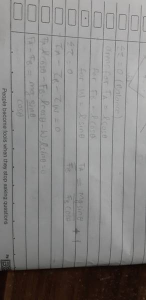

how about this? Sorry for the rotation. I cannot change it
The torque equation is correct. However, your answer should not have FB or mg on the right side otherwise you will not be able to select the correct choice from the given 6. You forgot the force equation. Use it to eliminate W from the torque equation, then find the ratio.

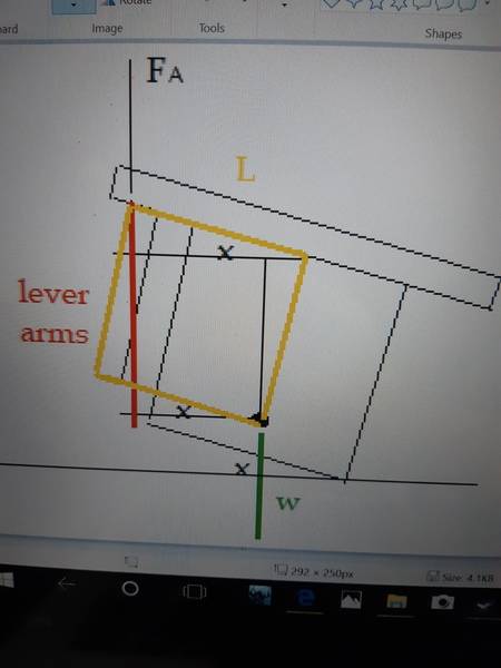

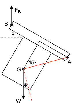

The distance from A to G where gravity acts is ##L\sqrt{2}##, not ##L##. Also the appropriate trig function should involve ##45^o-\theta##. Make a drawing and you will see.
Can you elaborate it? Why there is 45-##\theta## ? (Sorry for the pic)
Look at the picture below. (I just noticed that my drawing has points A and B interchanged, sorry). You want the angle ##\varphi## that is formed with distance AG (red line) and the perpendicular to it (dotted red line). Then the torque due to the weight is ##\tau_W=W (AG) \cos\varphi##. To find ##\varphi## note that when the table is rotated back to horizontal, the acute angle between the weight and AG becomes 45o. Apply similar reasoning to your picture which has points A and B interchanged. Hint: The answer will be slightly different from this picture.
