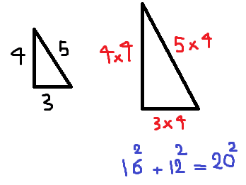

First of all, I agree with your answer.
Another way is that you square the denominator. Then you divide the numerator by denominator. Now you have a complex number in form of ##a+ib## and you know how to find modulus and argument of it.
$$\dfrac {2}{(4-2i)^2}=\dfrac {2}{12-16i}=\dfrac {2}{12-16i} \dfrac {12+16i}{12+16i}=\dfrac {24+32i}{400}=0.06+0.08i$$
Edit: You don't need calculator until the last part for calculating the argument.
$$(12-16i)(12+16i)=12^2+16^2=16(3^2+4^2)=16(25)=400$$
So there is no need to use calculator.

I would have done it this way:
$$z = \frac 2{(4-2i)^2} = \frac{2(4+2i)^2}{20^2} = \frac{24 +32i}{400} = \frac{3+4i}{50} = \frac 1{10}(\frac 3 5 + i\frac 4 5)$$So that ##|z| = \frac 1 {10}## and ##\arg(z) =\cos^{-1}(3/5) \approx 0.927##.
