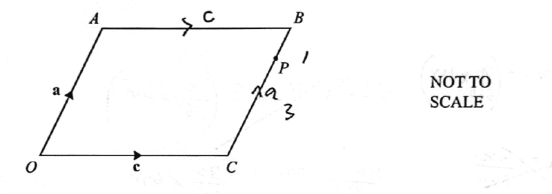

Geometry diagram of parallelogram OABC, marked NOT TO SCALE, with vectors a along OA and c along OC, point P on side BC, and handwritten labels 1 and 3 beside P and BC.
Printed text stating: OABC is a parallelogram. OA = a and OC = c. P is the point on CB such that CP : PB = 3 : 1.
Printed exam question part (ii): OP and AB are extended to meet at Q. Find the position vector of Q. Parts of the text are circled in red ink.

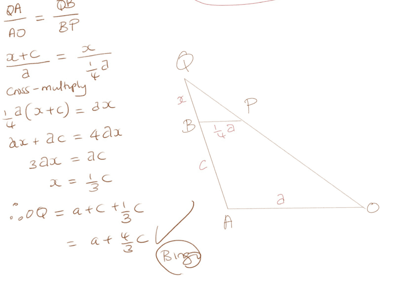

My approach; using similarity
Handwritten working on similar triangles: QA/AO = QB/BP, then (x+c)/a = x/(1/4 a), cross-multiplied to 3ax = ac, x = c/3, giving OQ = a + 4/3 c, marked Bingo. Beside it is a triangle OQA with B on QA and P on QO, BP parallel to OA, labelled x, c, a, 1/4 a.

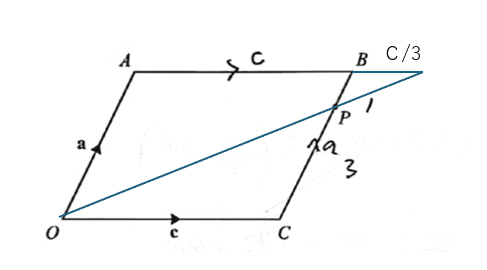

anuttarasammyak said:
Triangle OPC and QPB are similar with ratio 3.
And ΔQOA is similar to each of those two.
