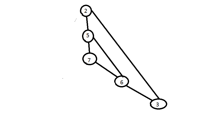

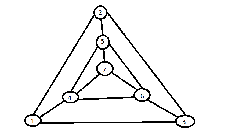

We have the following graph:
View attachment 5841 I want to find a minimal vertex cover.
I thought that the set $C^\star=\{4,5,6\}$ is a minimal vertx cover. Is this correct? How could we prove it? (Wondering) Then I want to find a vertex cover using the following approximation algorithm

I have done the following:

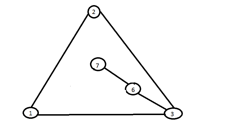

Suppose we start with e=(1,4) then C={1,4} and the graph is the following:

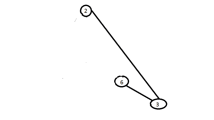

Then when we choose e=(5,7) we have C={1,4,5,7} and the graph will look as follows:

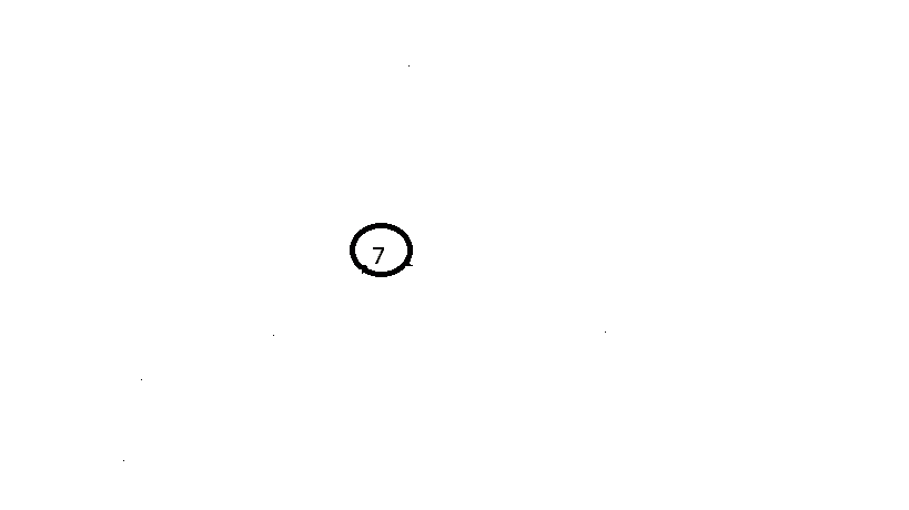

Then we can choose e=(2,3) and then we have C={1,2,3,4,5,7} and the graph will be:
Have we finished now?
Is a minimal vertex cover the set $C=\{1,2,3,4,5,7\}$ ? (Wondering)

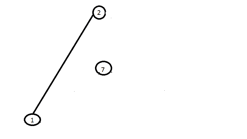

Suppose we start with e=(4,5) then C={4,5} and the graph is the following:
Then when we choose e=(3,6) we have C={3,4,5,6} and the graph will look as follows:
Then we choose e=(1,2) and then we have C={1,2,3,4,5,6} and the graph will be:
So, a minimal vertex cover is the set $C=\{1,2,3,4,5,6\}$, right? (Wondering)
Does this mean that no matter which edge we choose at each step the minimal vertex cover will contain $6$ vertices? (Wondering) After that I want to find a maximal independent set of vertices and a maximal clique. Could you give me some hints how we could find them? (Wondering)
No, the edge (1, 2) is not incident to any vertex in {4, 5, 6}.
This is a vertex cover, but it is not minimal because vertex 1 can be removed.
Oh yes... So, is it maybe $C^\star=\{1,2,3,7\}$ ? (Wondering)
At the step when we choose e=(1,2) do we not have to add both vertices, $1$ and $2$, to the set $C$ according to the algorithm? (Wondering)
