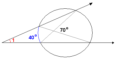

golb0016
See the attachment
Is the answer simply 70-40=30?
  • Circle with two secant lines from a point outside it, marked angle 1 at the external vertex, a blue arc labelled 40 degrees, and an interior angle labelled 70 degrees where two chords cross.
I'm pretty sure 40 degrees refers to that arc of the circle. In this case, you need two formulas:
1) Angle inside circle equals one-half of the sum of the intercepted arcs.
2) Angle outside circle equals one-half of the difference of the intercepted arcs.
70 = .5 (40+x)
x = 100
Angle 1 = .5(100+40)
Angle 1 = 70
However this answer is not an option. Where is my mistake?
Your mistake is in this line. The angle outside the circle is equal to half the difference of the intercepted arcs.
