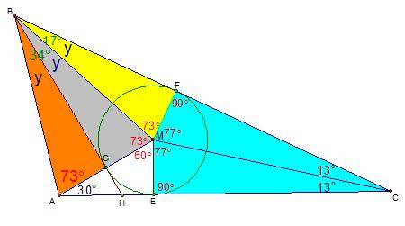

my solution:
from the sketch it is easy to prove that $\angle MBC=17^o=y=\dfrac {\angle ABC}{3}$

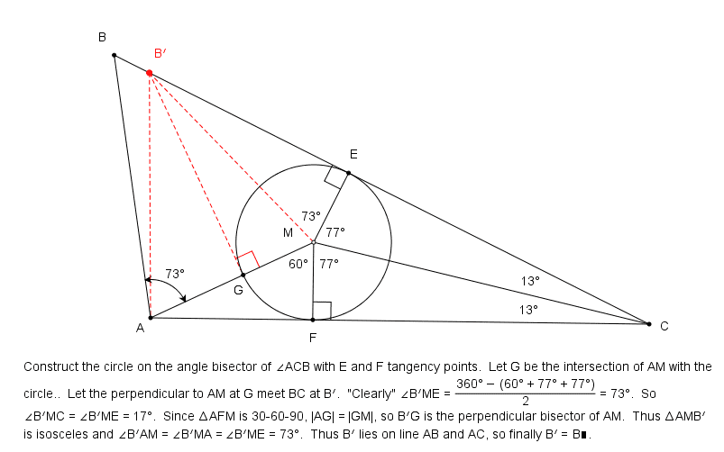

In case there are other people like me who took a while to follow Albert's clever proof, here is how it works. You are given the angles of triangle ABC: $103^\circ$ at A, $51^\circ$ at B and therefore $26^\circ$ at C. You are also given the angles of triangle AMC: $30^\circ$ at A, $13^\circ$ at C and therefore $137^\circ$ at M. Since 13 is half of 26 it follows that MC bisects the angle at C. So if we drop perpendiculars E, F from M to AC and BC, the right-angled triangles MEC, MFC will be congruent, with angle $77^\circ$ at M. Now draw the circle centred at M touching AC, BC at E and F, and let BG be the other tangent to the circle from B. Then the right-angled triangles BFM, BGM are congruent. At this stage we know the angles $60^\circ$, $77^\circ$, $77^\circ$ at M. So the remaining angle AMF is $146^\circ$ and this is bisected by BM. Therefore the angle BMF is $73^\circ$; and its complement, the angle MBC, is $17^\circ.$[/sp]

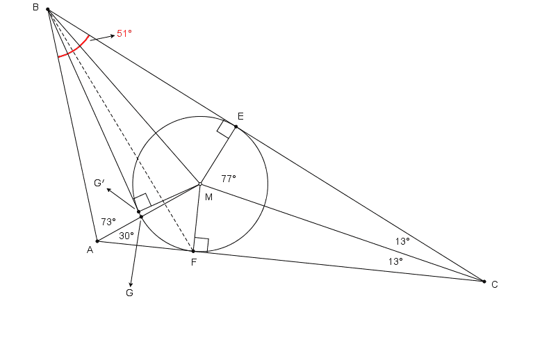

Opalg, maybe you can enlighten me about Albert's proof. I fail to see why G, the intersection of AM with the circle, must be a tangent point from B. I had played with the problem before looking at the solution and came up with the following:
So an indirect proof follows by showing the given construction must be the triangles as given in the problem. I think this is right.

johng said:
Opalg, maybe you can enlighten me about Albert's proof. I fail to see why G, the intersection of AM with the circle, must be a tangent point from B...
That is a very good point, which I had completely overlooked. The only way round it that I can see is to do essentially as you suggest. Namely, suppose that the tangent at G meets the line BC at some point B', and then show that B'=B.
MG is a radius , so $\angle BGM=90^o$
MG is a tangent line of circle M
here point M is the incenter of triangle BHC
That implies that you are defining G as the point where the tangent from B meets the circle. In that case, you need to explain why G lies on the line AM.

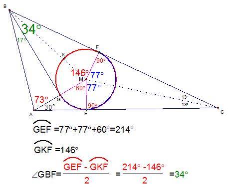

$\angle FBG=\dfrac{77+77+60-146}{2}=34^o$
$\therefore \angle GBA=17^o$
and $\angle AGB=180-73-17=90^o$
Yes, that seems to work. You are saying that the angles BAG and BAM are both $73^\circ$. So G (defined as the point where the tangent from B meets the circle) lies on the line AM.

Albert, Opalg, someone please help. I still don't get it. In Albert's expression for angle BFG, the 77+77+60 is the angle AME, but from where comes 146?? Is he saying triangle AMB is isosceles?
The following sketch shows G' as the second tangency point from B and G the intersection of AM with the circle. I still fail to see why G = G'. (Of course the drawing is not accurate; the actual problem has G = G'.)

146=360-77-77-60
Albert said:
146=360-77-77-60
Yes, but the problem is that prove that it are those angles and not others

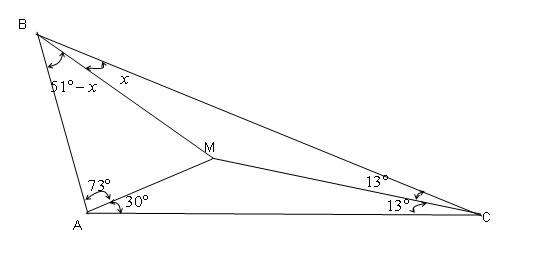

My solution:
Ceva's theorem tells us the product of the ratios of the pairs of segments formed on each side of the triangle by the intersection point is equal to 1.
Hence we have
$\dfrac{\sin 13^{\circ}}{\sin 13^{\circ}} \cdot \dfrac{\sin 73^{\circ}}{\sin 30^{\circ}} \cdot \dfrac{\sin x}{\sin (51^{\circ}-x)}=1$
$\sin 73^{\circ}\cdot \sin x=\sin 30^{\circ} \cdot \sin (51^{\circ}-x)$
$\sin 73^{\circ}\cdot \sin x=\sin 30^{\circ} \cdot (\sin 51^{\circ} \cos x-\cos 51^{\circ} \sin x)$
$\sin x(\sin 73^{\circ}+\sin 30^{\circ}\cos 51^{\circ})=\sin 30^{\circ} \sin 51^{\circ} \cos x $
$\begin{align*}\tan x&=\dfrac{\sin 30^{\circ} \sin 51^{\circ}}{\sin 73^{\circ}+\sin 30^{\circ}\cos 51^{\circ}}\\&=\dfrac{\dfrac{1}{2} \sin 51^{\circ}}{\sin 73^{\circ}+\dfrac{1}{2}\cos 51^{\circ}}\\&=\dfrac{\sin 51^{\circ}}{2\sin 73^{\circ}+\cos 51^{\circ}}\\&=\dfrac{\sin 3(17)^{\circ}}{2\sin (90-17)^{\circ}+\cos 3(17)^{\circ}}\\&=\dfrac{\sin 17^{\circ}(3-4\sin^2 17^{\circ})}{2\cos 17^{\circ}+\cos 17^{\circ}(4\cos^2 17^{\circ}-3)}\\&=\dfrac{\sin 17^{\circ}(3-4\sin^2 17^{\circ})}{\cos 17^{\circ}(2+4\cos^2 17^{\circ}-3)}\\&=\dfrac{\sin 17^{\circ}(3-4\sin^2 17^{\circ})}{\cos 17^{\circ}(4(1-\sin^2 17^{\circ})-1)}\\&=\tan 17^{\circ}\end{align*}$
$\therefore x=17^{\circ}$
Yes, you are right again, and this time I don't see any way to fix it. The distorted diagram showing G and G' as distinct points highlights the difficulty in Albert's argument. Fortunately, anemone has now given us a watertight proof using Ceva's theorem.

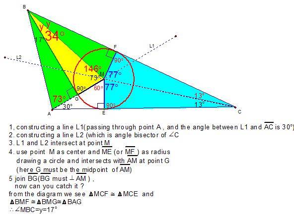

Albert said:
hope this time you can understand it
Ah, I applaud your constant effort to try to show us the reasoning behind your work...but Albert, I only managed to follow up to where you mentioned why $G$ is the midpoint of $AM$, and I don't see how that would imply the two lines $BG$ and $AM$ are perpendicular to one another.
Also, if I could decipher that, what follows immediately is that the two triangles $BGA$ and $BGM$ are congruent triangles and hence $\angle ABM=180^{\circ}-2(73^{\circ})=34^{\circ}$ and that gives $\angle MBC=51^{\circ}-34^{\circ}=17^{\circ}$.

please see post #9
Using your diagram and if it were up to me, I would continue, after I realized $G$ is the midpoint of $AM$, by using the trigonometric approach! Please pardon me because to prove something using only geometrical approach is my downfall. :o

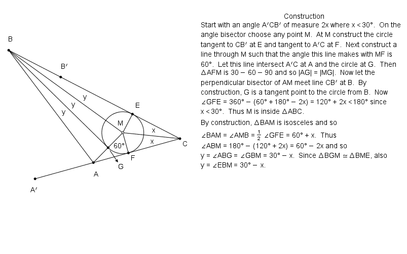

I promise this is my last post to this thread. It is basically my post 5, but I am now happy with the proof. (Of course the figure as drawn is inaccurate.)
