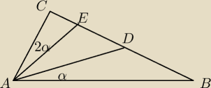

In triangle ABC $AC=BD, CE=2, ED=1, AE=4$ and $\angle CAE=2 \angle DAB$. Find area ABC.
  • Triangle ABC with points E on side CB... wait, E lies on segment AC-side and D on side BC; angles at A marked 2α between AC and AE and α between AD and AB, with points C, E, D, B labelled.

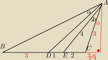

This is what it looks like, but how to justify the red ones or maybe there is another way?
  • Geometry diagram of triangle ABC with B on a horizontal line at left, D and E on that line, and C on it near right. Lines run from A to B, D, E and C. Labels show BD = 3, DE = 1, EC = 2, AE = 4, AC = 3, C to foot of perpendicular = 3/4, angles alpha, 2alpha, and red dashed altitude from A.
In your diagram, all three sides of $\triangle AEC$ are known. Using the law of cosines you get $2\alpha = \cos^{-1}(7/8)$ and $\alpha \approx 14.47751219^{\circ}$.
Continuing to use the law of cosines we get $AD=\dfrac{3\sqrt{10}}{2}$ and $AB=3\sqrt{6}$.
Finally, using the law of cosines on $\triangle ABD$ we get $\alpha \approx 71.170769^{\circ}$.
Your diagram is incorrect.
