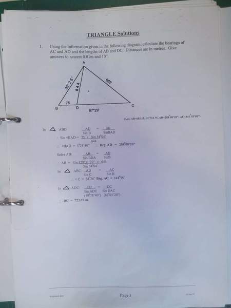

Hey,
I am studying for a test and i am having trouble with this problem. I have attached a photo of the worked solution. For the first part of the triangle (ABD) I understand everything except how they got the bearing AD. How do you find this bearing from the angle BAD.
You know the angle ABD, and angle BAD has just been calculated. Angle ADC follows from these by a bit of basic geometry.
Thanks for your help, but I'm still wondering how to find the bearing AD which is (208°00'20"). I found the angle for BDA (120°31'21") do i need to do something with that to find bearing AD, I am still confused.
Right, so angle ADC is 180 minus that. You now have the bearing of DC and the angle ADC, so it's easy to deduce bearing DA. Just add/subtract 180 for AD.
I looked over it again and that didn't really work out. So angle ADC is 180 minus 120°31'21" . This equals 59°28'39" you said this would equal the bearing DC, however the bearing DC is already given in the question which is 87°29'. I don't know what i did wrong.
I did not say that. I listed what you would know after you had worked out the angle ADC: the angle ADC and the bearing of DC. From those you can compute the bearing of DA.
