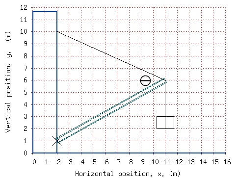

A crate with a mass of 181.5 kg is suspended from the end of a uniform boom. The upper end of the boom is supported by the tension of 2323 N in a cable attached to the wall. The lower end of the boom pivots at the location marked X on the same wall. Calculate the mass of the boom.
Coordinate diagram of a boom from pivot X near (2, 1) to a crate at its end near (11, 6), with a cable running from (2, 10) on the wall to the boom end; crate drawn as a box near (11, 2.5).
L - length of boon
Ff - friction
T - tension
Wb - weight of boon
W - weight of box
net forces in x direction = Ffx - Tx
net forces in y direction = Ffy + Ty - Wb - W
net torque = Wb(L/2)cos(theta) + WLcos(theta) - TLsin(theta)
This is what I did exactly: I set up the above equations and then worked with the torque equation setting the tension equal to the weights. I canceled out the L's and reset up the problem so that it was equal to what I wanted to find, Wb. Upon doing that I got this equation: (2Tsin(theta) - Wcos(theta))/cos(theta) = Wb. I eliminated the cos in the denominator and got 2tan(theta) - W = Wb and from there I dervied theta from the graph making a right triangle with the boon as the hypotenuse I took the tangent of 5/9 and got 29.1 for theta and filled that into the equation. However, obviously that didn't get me the right answer, so I'm wondering what I'm doing wrong. Help would be appreciated.

sorry here's where my theta is in respect to the graph:
Coordinate diagram with horizontal position x and vertical position y in metres, showing a wall at the left, a sloped boom from the bottom left to a pivot near (11, 6), a cable from the wall top at (2, 10) to the pivot, a circled theta marking the angle at the pivot, and a crate hanging from a vertical cable below the pivot.
That's the correct angle to use when calculating the torque due to the cable tension--the last term in your torque expression. But that's not the same angle you need for calculating the other torques.

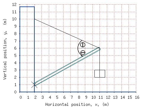

I wanted to try to explain without having to spend time amending the graph in photoshop, but I guess it just got confusing so here's my line of thinking:
Coordinate diagram of a boom: a line from (2, 10) to (11, 6) forms a cable to a hinge at the top of a wall at x = 2, with a lower boom from about (2, 1) to (11, 6); a box sits near (11, 2), and two angles are marked by arcs at the hinge, labeled 1 and Θ.
as you can see I renamed theta as just the angle you would use to find the lever arms for the weights. Now from my understanding the angle you use to find the lever arm for the tension would be the sum of theta plus the angle above it, as a labeled in the graph so that whole angle that I arced out would be the angle you use to find tension's lever arm.
This looks good. (I assume your angles are with respect to the horizontal.) If you are still not getting the correct answer, show what you did step by step.
ok, I'll give it to you step by step:
1) upon realizing my mistake of using the same angle to derived all the lever arms, I amended the graph to the one shown above and found the apropriate angles.
2) since the picture is place on a graph, drawing lines across from (2,6) to (11,6), I created two right triangles. I counted up 5 spaces and across 9 spaces to find the legs of the bottom triangle and found theta by taking the inverse tangent of 5/9 which came out to be approximately 29.1 degrees for theta
3) for the top triangle using the same methods in the previous step I counted up 4 spaces and across 9 spaces and and took the inverse tangent of 4/9 which came out to approximately 24.0 degrees for phi
4) I deduced that theta would be used to derive the lever arms for the vertical forces down for the weights, and in the case of the tension the angle to be used to find the lever arm of that force would be the sum of phi+theta. phi+theta = approximately 53.0 degrees, this new angle of phi+theta I will call alpha
5) I original derived a torque equation before I calculated the angles:
net torque = Wb(L/2)cos(theta) + WLcos(theta) - TLsin(alpha)
I rearranged the equation so that it would equal my unknown
(2Tsin(alpha) - Wcos(theta))/cos(theta) = Wb
4) Filling in my numerical values I got this:
2(2323)sin(53.02) - 1778.7cos(29.05)/cos(29.05) = Wb
the 1779.7 is the mass of the crate (181.5) times 9.8, and the extra decimal places for the angles I put in for the sake of accuracy
5) Completing that math I got approximately 2471 and divided that by 9.8 to get the mass and got approximately 252.2, however this answer is incorrect so where did I go wrong?
Good.
You should also have a 2 in front of the W:
(2Tsin(alpha) - 2Wcos(theta))/cos(theta) = Wb
ah, you know that's probably what I'm doing wrong, thanks again.
