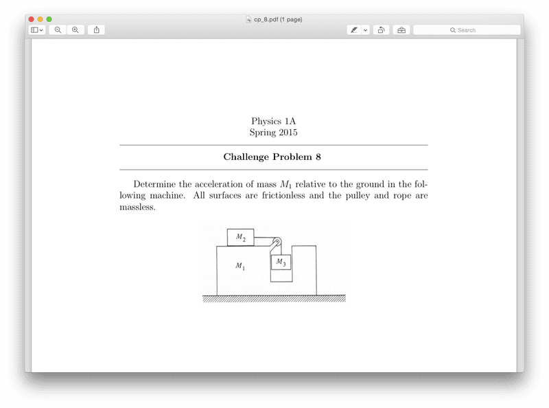

Additional instructions:
Analyze the motion of the system in an inertial frame of reference fixed to the table on which M1 slides. You can't analyze the system with Newton's Laws in the frame of M1 because M1 will accelerate, and that frame will not be inertial. When you do this analysis, you're also going to need to find constraints relating the accelerations of the various masses. Try to determine these constraints in a way similar to what I did in class with the block on the wedge. It may help to note that the since M2 and M3 are attached by a rope, their motions are related.

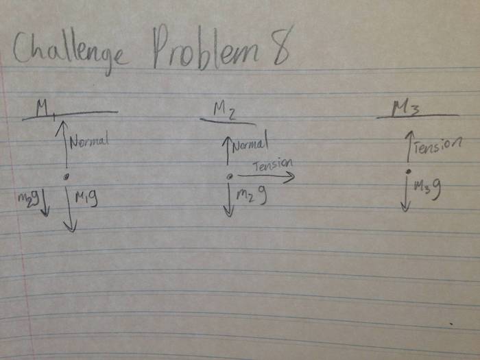

I am completely lost. I spent pretty much all day working on this problem, to no avail. I know what the final answer should be, but I am having trouble finding how to get there.
Here is what the final answer should be:
m2m3g/(m1m2 + m2m3 + m1m3 + m2m3 + m3m3)
Thanks in advance for your help!

I am pretty confident that the tension force will cause block 2 to move to the right. As a consequence, block 3 will move downwards, since it is attached to block 2. I found this tension force to be equal to m3g, which makes block 2's acceleration to be equal to m3g/m2.
Since blocks 2 and 3 are attached by a rope, the x position of block 2 and the y position of block 3 should equal a constant. I made that into an equation, and after taking two derivatives of both sides with respect to time, I got an equation relating the two blocks' accelerations, and I learned that block 3's acceleration in the y direction is equal to -m3g/m2.
However, all of this information doesn't really tell me anything about block 1's acceleration, considering the fact that there is no friction.
I drew a free body diagram for block 1 and it looks like the only forces acting on it are the downward forces of block 2 and gravity, and the upward normal force of the ground. These don't affect the y-position of block 1 because the net force is 0. I don't see any forces acting on the block in the x-direction, so I'm inclined to think that block 1's acceleration is 0. However, I know that that is not the correct answer; as noted above I know that the correct value of block 1's acceleration should be nonzero.

Well, you can do it by drawing free body diagram for all of the components, but it is nothing I would recommend ... You will also need some additional constraints on the movements of the blocks.
That's what other higher level physics students have told me... but free body diagrams are the only tools I have. Maybe that's why I'm having so much trouble with the problem
So why don't you tell us what you've got for each of the blocks so far? What relations do you have?
You are missing several forces, namely the forces that are acting:
1. Horizontally on the mass ##m_1##.
2. Horizontally on the mass ##m_3##.
You are also missing a constraint based on the length of the string being constant.
Edit: Think back on Newton's third law. For every action, there is an equal and opposite reaction. Do all your force pairs consist of equal, but opposite forces?

I think you can figure this out if you only think a bit and ponder on Newton's third law. For each force you draw in your free body diagrams, there needs to be an equal and opposite counter force. For which forces that you drew is this not true?
All of the forces are accounted for, except for the forces exerted onto the ground and the forces exerted onto the rope. I assumed that these are irrelevant, but maybe they are actually relevant.
I could be missing something though
The forces in the vertical direction are all irrelevant (except the one acting on ##m_3##) as they will be countered by normal forces transmitted to the ground.
The horizontal force on the pulley from the rope is definitely not irrelevant. The pulley is a part of ##m_1##!

Yes, I have been hinting at this for 20 minutes and wanted him to figure this out for himself ...
Can you explain why the rope applies a force onto the pulley in that specific direction? I guess I'm really confused about how rope forces work.
Try drawing a free body diagram for any pulley attached to some ropes. Note that the horizontal force is not the only force acting on the pulley. There is also the vertical force which is the force pair with the tension force acting on ##m_3##, but that one is going to be countered by a normal force from the ground.
