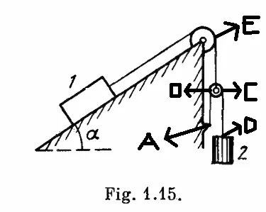

I’m not looking for the final equations themselves, but rather an explanation of the physical and geometric ideas used to construct constraint equations in systems involving strings and pulleys. How should one think about these constraints in a systematic way?
Diagram of a block labeled 1 on an incline at angle α, connected by a string over a pulley at the top of the incline to a hanging block labeled 2; a second pulley with points labeled A, B, C, D, E marks the string geometry. Fig. 1.15.

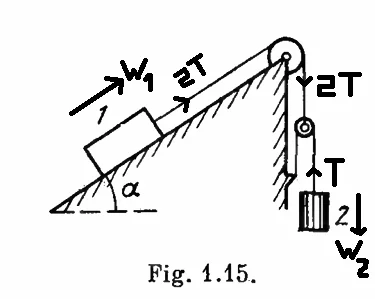

Fig. 1.15: block 1 on an incline at angle α, pulled up by a string over a pulley at the top, with tension 2T along the incline, and a second pulley below carrying a hanging weight W2 with tension T; labels W1 and 2T marked.

Physical constraints are usually based on a physical understanding of the problem. In general, we have to figure out how to apply Newton's laws to any given problem. In this case, the block is constrained to move up and down the ramp; and, the length of the string joining the block to the hanging weight must be constant.
If you ask how I know that, then it's not easy to explain.

Can you teach me how I can create an expression relating the accelerations of the masses 1 and 2 by double differentiating the length segment functions with respect to time? It took me 2 hours just to create an expression, and I would like to listen to how u think of solving these kinds of problems.

You could post this under homework. I looked more closely and those diagrams and it's a little complicated. Three suggestions:
1) You need to figure out how many degrees of freedom the system has. The weight can move down (or up); the pulley can move down (or up); and, then weight can move up the ramp (or down).
2) Consider a small displacement from the starting position. If the weight moves down ##\Delta y_W## and the pulley moves down ##\Delta y_P##, then you can figure out how much the weight must have moved ##\Delta x##. Note I'm using ##x## for the direction up the slope.
3) Consider using conservation of energy, rather than forces and tensions.
Note that if you have an equation involving displacements ##y_W, y_P## and ##x##, then you can differentiate that equation with respect to time and get an equation for the velocities ##v_W, v_P## and ##v_x##. Velocities are what are needed for the energy equation.
Alternatively, you could differentiate again to get an equation in the accelerations and relate this to the forces and tensions involved. But, from experience, I'd say energy is the way to go for a problem like this.

my bad it was given in the question that we were supposed to assume the mass 2 accelerating downwards. Yea, as you suggested (2), I followed that approach of taking small displacement, differentiating the function (once/twice) and I found that 2a1 = a2. Also thank you :)

I guess you eventually need to express ##a_1## as a function of ##m_1, m_2, \alpha## and ##g##?

yeah I had to.
