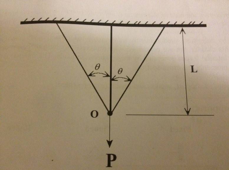

I'm supposed to find the forces in the members as functions of P ans θ.
Same Young's Modulus and area for all of them which is E and A
and then calculate the vertical deflection.
none
I named the members from theft to right A, B and C and the forces TA, TB and TC respectively.
I started with equilibrium equations and got
TA=TC
2 TAcosθ + TB= P
Now I tried to use the modulus equation σ/ε or FL/Aex
and I can't figure out a way forward from here. Any suggestions?
Plus my first gut feeling tells me the force in B is P and the rest is 0 but its a past paper and the question was 8 marks which means there's more to it obviously.
  • Diagram of a three-bar structure: a horizontal support with hatching above, with a central vertical bar and two outer inclined bars meeting at a joint O, each outer bar making angle θ with the vertical. Length L is marked from the support to a horizontal line, and load P acts downward at O.

Since you are told the modulus, there is some stretching involved, so the geometry is altered by the load. Are the angle theta and length L for the loaded or unloaded geometry?
In terms of L and θ, what are the original lengths of the sides of the triangles? If the point P displaces downward by a distance δ, what is the new length of the vertical wire? Since the side of the triangle at the wall doesn't increase in length when the point P is moved downward, what does the pythagorean theorem tell you about the new lengths of the slanted wires? What are the strains in the vertical wire and the slanted wires? In terms of δ, what are the tensions in the wires? Assuming that, for purposes of the force balance, the angle θ changes negligibly, what is the downward displacement δ?

I didn't really say that the change in theta should be ignored. I only said it could be ignored in the force balance. In quantifying the kinematics of the deformation, it is essential to take it into account, as you indicated.
The original three sides of the triangle are L, Lsecθ, and Ltanθ. As you indicated, the Ltanθ side remains constant during the deformation. The new lengths of the sides should be L+δ, Ltanθ, and [itex]\sqrt{(L+δ)^2+(L\tanθ)^2}[/itex]. If we linearize the latter with respect to δ, we find that [itex]\sqrt{(L+δ)^2+(L\tanθ)^2}≈L\secθ+δ\cosθ[/itex]. So the strain in the slanted wires is [itex]\frac{δ}{L}\cos^2θ[/itex].
So the tension in the vertical wire is [tex]T_B=EA\frac{δ}{L}[/tex]
and the tensions in the slanted wires are [tex]T_A=EA\frac{δ}{L}\cos^2θ[/tex]
These can be substituted into the vertical force balance to determine δ.
EDIT: There was a small error in the previous version of this post that I corrected. It did not affect the final results.

If the deformed length of the slanted wires is Lsecθ+δcosθ, then the strain is:
[tex]ε=\frac{(L\secθ+δ\cosθ)-L\secθ}{L\secθ}=\frac{δ\cosθ}{L\secθ}=\frac{δ\cos^2θ}{L}[/tex]
Does that help?
