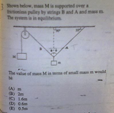

Physics diagram of a frictionless pulley system: mass M hangs on the left over a pulley, strings B and A run from the pulley and a ceiling anchor to a central knot holding mass m, with angles marked at the top. Answer choices A to E follow.

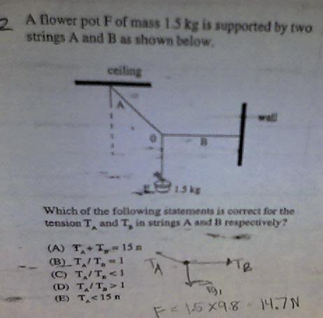

Physics problem diagram: flower pot F of mass 1.5 kg hangs from string A attached to a ceiling and string B attached to a wall, with answer choices (A) to (E) about tensions T_A and T_B and a force diagram showing 14.7 N.

1. I don't understand it at all.
2. F of M: T=9.8M
Fx of m: TB x= TA x
Fy of m: TB y + TB y= Fg (TB y + TB y= 9.8m)
I don't know what to do from here.
3. TA> TB That's all I understood.
Any help is appreciated.
3. Since TA is greater than TB, TA/TB >1, right?
