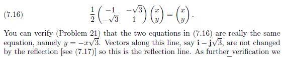

Printed textbook page showing equation (7.16): one half times a 2 by 2 matrix with entries -1, -√3, -√3, 1 applied to (x, y) equals (x, y), followed by explanatory text about verifying the equations and the line y = -x√3.
Ok, so I attached this here, as they cover the same problem again later on in the next chapter. According to this here, it states the answer I wrote earlier ## y = -x\sqrt(3) ## is the reflection line, but you said it wasn't???
From what they further discuss in this part, it seems like for the equation of the line, you just solve for y, so basically multiply the matrix M by ##\begin{bmatrix} 0 \\ 1 \end{bmatrix}## , which is essentially giving you the y value of the problem.
For their final solution, it seems like you do set it to 0 to put it in ##y = mx + b## form. I mean it's what I did, it's what they state later in the book here, so what am I missing here?
In your first post and later you said you multiplied the transformation with (x,y) and then equated to this to zero which then gives the (wrong) result ##y = -x/\sqrt{3}##. Since you have the answer readily available in your textbook you should be able to spot the difference between your and their answer.
On top of that I must admit that I probably did add confusion more than help by initially replying about what a reflection line means for a general transform and not the specific one you posted. So just ignore that and focus on what your textbook does to get to the correct result.
For what I have read so far, I would guess you are missing that you need to establish an equation like the one you quoted from your textbook in post #10. Are you good with why they equate the transformed point to the point itself?
