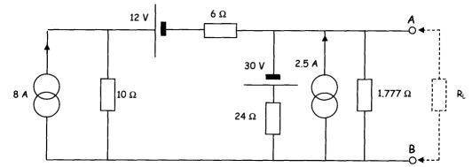

Hi there,
See attached for original circuit.
Basically I need to find thevenins equivalent of the network.
My attempt:-
To find the resistor equivalent
First of all I replaced all voltage sources with shorts, and replaced all current sources with open circuits.
This left me with 16 ohm (10+6),24 ohm and, 1.777 all in parallel.
The sum of the resistors gives the equivalent resistance of 1.499 ohm.
Now this is the part where I don't know what to do next. Do I convert the circuit so the sources are voltage sources?
Any help or guidance most appreciated
Any guidance much appreciated!
  • Circuit schematic with an 8 A current source and 10 Ω resistor in parallel, a 12 V source in series with 6 Ω, a 30 V source in series with 24 Ω, a 2.5 A current source and 1.777 Ω resistor in parallel, and terminals A and B with load R_L.

Hi, I suggest that you do the transformation so all the voltage sources and current sources can be unite into one. This is just a suggestion.Please correct me if I'm wrong. Thank you!
You need to find the open-circuit voltage across A and B with all the sources activated. This will be the Thevenin equivalent voltage.
I believe using source transformations would have also worked...
