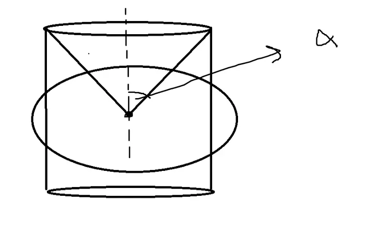

here is my attempt at option B
I'm trying to calculate the plane angle subtended by the top cylindrical surface, and then use the flux per unit solid angle, to calculate the flux through the top surface. By symmetry, the flux through the bottom surface would also be the same. Also, the flux through the curved surface will be zero, as the electric field inside a spherical shell is zero. However, I'm facing great difficulty in calculating the solid angle in the first place. all help is appreciated.

palaphys said:
[for option B] I'm trying to calculate the plane angle subtended by the top cylindrical surface, and then use the flux per unit solid angle, to calculate the flux through the top surface. By symmetry, the flux through the bottom surface would also be the same. Also, the flux through the curved surface will be zero, as the electric field inside a spherical shell is zero.
That's not correct. If you draw a diagram, including some lines of flux, you will see some lines of flux pass through some of the cylinder's curved surface (as well as through its end faces).
palaphys said:
how do I proceed using the solid angle approach? is it even correct?
Using solid angles (if you use the correct ones!) works. You may find it useful to do a search for 'area of a spherical cap' - there is a simple formula which, I guess, you can take as provided (rather than have to prove). Then it's easy to find the solid angle subtended by a cap.

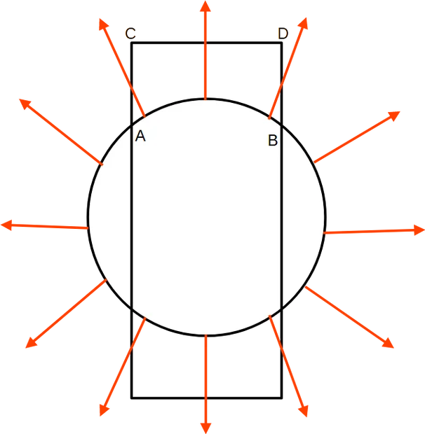

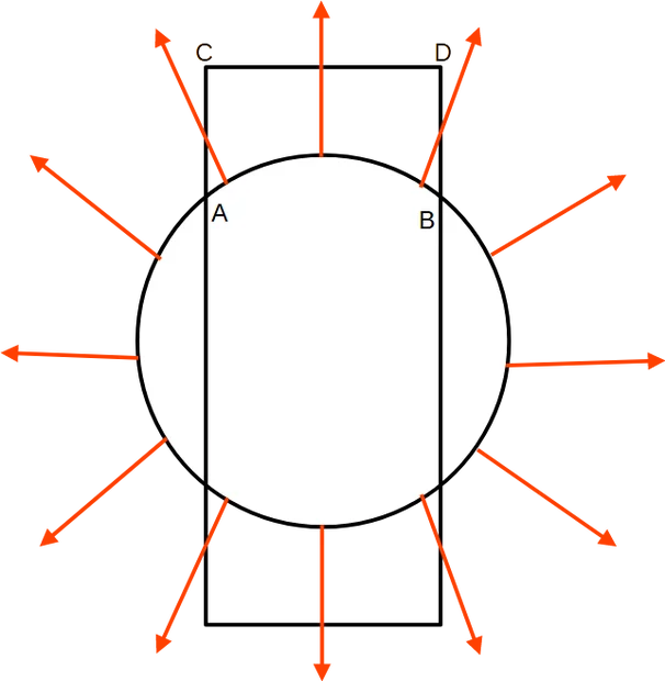

Look at the diagram below (not drawn accurately) which shows a central cross-section of a cylinder intersecting a spherical charged shell.
a) Some lines of flux go through through the cylinder faces (e.g. through CD).
b) Some lines of flux go through part of the curved cylinder side (e.g. through AC and BD).
c) The remaining lines of flux do not go through the upper part of the cylinder.
Curve-AB corresponds to a spherical cap. Lines of flux which start on this cap are the ones that pass through the top part of the cylinder (corresponding to a)+ b) above). Similarly for the cap at the bottom.
The surface area of the sphere is ##4 \pi R^2## (corrected - see Post #7). If you can find the area of the cap (see previous post) then you know the cap’s area as a proportion of the sphere’s area. The flux through the cylinder then follows.

Steve4Physics said:
We don't provide homework solutions! But we can gives help/pointers.
EDIT. Tried to improve wording. And a correction.
think I got it. so I'll try to find the charge enclosed by the cylinder, using the fact that the entire spherical surface carrying a charge Q subtends an angle of 4pi str, and so the part of the spherical surface inside the cylinder subtends______ and hence carries a charge with respect to this.
Is this the way to proceed?
That sounds right. Note that "the part of the spherical surface inside the cylinder" is called a "spherical cap". So the charge inside the cylinder is the charge on the two spherical caps.
