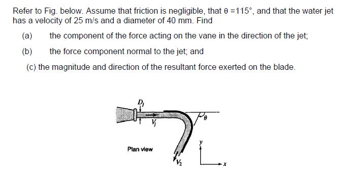

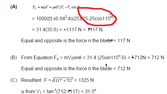

why the author gave the change in velocity as (25- 25cos115) , shouldn't it be final - initial velocity , which is (25cos115 -25) ?
  • Plan view diagram of a water jet with velocity V1 entering a curved vane or blade, which turns the flow through angle theta, leaving with velocity V2; the x and y axes are shown with the jet direction labelled.

  • Handwritten worked solution with parts A, B and C computing jet force on a blade: Fx = mΔV = ρAV1(V1 - V2 cos θ), then 1000(π x 0.04²/4)(25)(25-25cos115°) = 31.4(35.6) = 1117 N, with a red circle around the term 25-25cos115°.
I agree. At that point, the author is calculating the force the vane exerts on the water, which with positive to the right should be negative.
