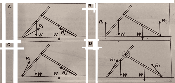

2,522
395
Two identical uniform rods each of weight W are hinged together to form a structure which is resting on rough floor as shown (please see below). If the reaction forces acting on the structure by the floor are ##R_1## and ##R_2##, which of the following shows the forces acting on the structure?
Resultant torque = 0
Resultant force = 0
Picture from the question
Diagram of two uniform rods hinged together at the top, leaning against a rough floor with the lower ends resting on the surface, forming an inverted V shape.
Options:
Four labelled options A to D, each showing two rods hinged at the top forming an A-frame on a horizontal floor, with forces R1, R2 and weights W marked as arrows at different positions.

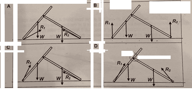

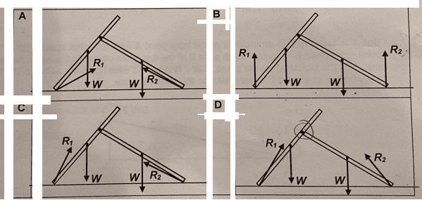

Option (B) is wrong because the both reaction forces have to be slanted since they are resultant of normal force and frictional force.
I think option (C) is wrong because taking the point where the two rods meet as point P and comparing the torque produced by both weights, the torque by the weight of right rod will be larger since the perpendicular distance is larger so there will be clockwise net torque due to bot weights only. Torque produced by both R1 and R2 are also clockwise to the net torque of the system can't be zero.
My guess would be (D) because it seems like R2 will produce bigger counter clockwise torque to balance the net torque from the weight compared to R1 in option (A)
Is there a certain way to determine the correct answer?
Yes.
It's a hinge, so consider the torque balance about P for each rod separately.
haruspex said:
Yes.
Ah I see, so the correct answer is certainly (D)
