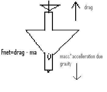

An aircraft of 5000kg mass is diving vertically downwards at a speed of 500 knots. The pilot operates the dive brakes at a height of 10 000m and reduces the speed to 325 knots at 7000m. If the average air resistance of the remainder of the aircraft during the deceleration is 15KN what average force must be exerted by the dive brakes? (assume the engine is throttled back and is not producing any thrust)
V2=u2+2as
where V= final velocity
u=original velocity
a=acceleration
s=distance
First convert velocities into m/s. 1 knot=0.5145 m/s so:
u=500 knots=257.25 m/s
v=325 knots=167.21m/s
transposing above formula for a: a=(V2-u2)/2s
=-6.3696m/s2
The force causing the plane to acelerate downwards is mass*gravity (mg) so to stop the acceleration the drag force would have to be equal to mg. 5000kg * 9.81m/s2=49050N As the drag force acts opposite to acceleration call it -49050N
To acelerate the plane (in this case opposite to direction of travel) there must be an additional force of mass * aceleration (ma). 5000kg*-6.3696m/s2=-31848
The total drag force would be: (force equal to mg)+ma
-49050N+-31848N=-80898N
These figures are -ve because they are based on a negative aceleration so the actual drag force is +80898N
Take away from this the air resistance without dive brakes of 15000N=
65898N
The answer is given as 16.62KN, I have given this a lot of thought but can't work out where I've gone wrong. Any help please?

Don't take any shortcuts, draw a free body diagram to identify all the forces, then use Newton 2, Fnet = ma. The air resistance force is the drag force and is given. You have the weight force. Solve for the dive brake force, using Newton 2 and the correct value of the acceleration you determined (the acceleration and the net force must be in the same direction...which direction is that?).
Edit: In checking your work, you appear to have arrived at the correct answer using an unorthodox method.

The answer of 16.62KN from my last post is from the book I'm working out of. The answer I arrived at was 65.9KN which is why i posted here.
https://www.physicsforums.com/attachments/35372
I have attached my attempt at a free body diagram here.
The Fnet and acceleration must be in an upwards direction as the plane is going straight down and is slowing.
From reading your reply I think I just need to multiply the mass of 5000kg by the acceleration of 6.3696m/s2 which gives 31848N. Subtracting the 15000N of air resistance gives 16.848KN. That seems quite close to the correct answer but I've somehow gained 228N
I think where I went wrong with my first attempt was that I assumed the plane was still accelerating due to gravity when the dive brakes were deployed. If this was the case would there be a force of mg reqiired to halt the acceleration in addition to the force accelerating the plane upwards as I thought?
Hope I have made my thoghts clear. Apologies if not.
thanks again
ed
What I meant is that you were right and the book was wrong.
Fnet = ma
Brake drag + other drag - mg = ma
Brake Drag + 15,000 - 5000(9.8) = 5000(6.37)
Brake Drag - 34,000 = 31,850
Brake Drag = 66,000 N
You had it right the first time...but be meticulous when using Newton's 2nd law.
