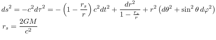

I need help to figure out how the formula for the velocity of a circular orbit can be derived from the Schwartzschild metric .

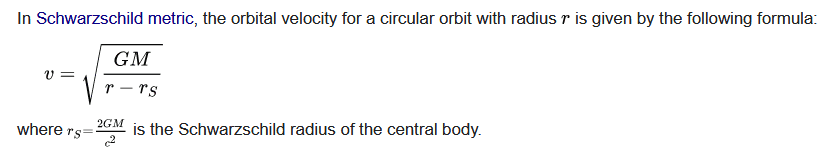

Below are equations/formulas/text from
I apologize for not remembering the source for the "v=" equation, or for my inability to find it again.
For a circular orbit, the distance r and proper distance s are both constant. Therefore
ds = dr = 0.​
Assume the coordinates are such that the orbit has:
sin ϑ = 1, and dϑ = 0.​
Therefore the metric an be written
##{r^2 {dθ}^2} = {c^2} /sqrt {1-r_s/r}} {dt}^2 ##
## r = 1##
(I have no idea why the attachments do not get displayed.)
ds = dr = 0.​
The metric can now be written:
## r {\frac {dθ} {dt}} = c {\sqrt {{1-{r_s}/r}} } ## .​
See equation 7.52 in Carroll's GR lecture notes, which relates the radius ##r_c## of a circular orbit to the specific angular momentum ##L##, and ##L=r_c^2(d\phi/d\tau)##.
Once you have ##d\phi/d\tau## you can use the fact that the four velocity is normalised to 1 to write ##1=g_{00}\left(\frac{dt}{d\tau}\right)^2+g_{33}\left(\frac{d\phi}{d\tau}\right)^2## with the metric components evaluated at ##r=r_c, \theta=\pi/2##. Now you have the only two non-zero components of the four velocity of your orbiting object.
Now you write down the four velocity of a hovering observer. This is just ##(1/\sqrt{g_{00}},0,0,0)##. The inner product of this with the four velocity of your orbiting object is the Lorentz gamma factor associated with that orbit. That is, ##\gamma=\sqrt{g_{00}}\frac{dt}{d\tau}##. You can calculate the velocity from here, I think.

The process I outlined will get you the velocity measured by a hovering observer at the same altitude. An observer at infinity would measure it to travel slower by a factor of ##1/\sqrt{1-r_s/r_c}## due to gravitational time dilation.
