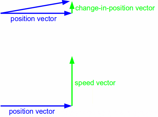

At the chance of confusing you more, I'll try to explain anyway. :smile:
Here's a picture that I drew to see if I can make it clearer.
In the top drawing I've drawn 2 subsequent position vectors (blue).
Between them I've drawn the change-in-position vector (green).
The change-in-position vector is the difference of the 2 position vectors.
In the bottom drawing, I've drawn the same initial position vector (blue).
And the speed vector that the object has at that point (green).
As you can see, the change-in-position vector points the same direction as the speed vector.
The difference is that the speed vector is longer.
That is because we only go into the direction of the speed vector for a short time interval.
After that time interval the speed will have changed a little under the influence of the centripetal acceleration.
Makes perfect (physics) sense :) Yes, I do get it now, and I've seen a drawing similar to yours just now in mechanics class... in fact. Thanks for all your effort, ILS, you're amazing :)
