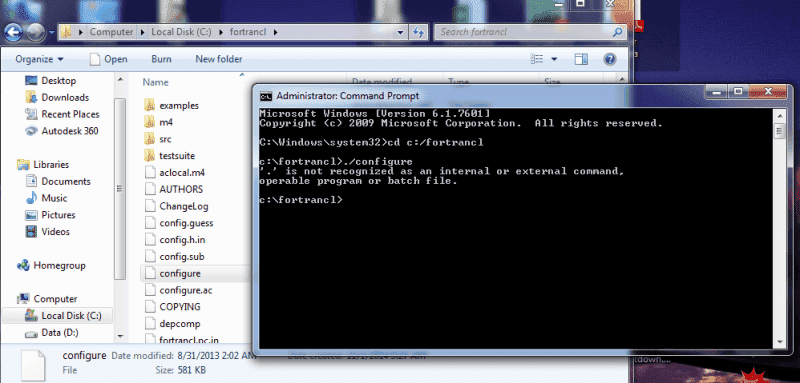

Hi!
I wanted to ask if anybody here has any experience with FortranCL, the Fortran implementation of OpenCL.
If so, I would be really thankful if you could help me in setting up the programming environment to use it. So far, I downloaded the MinGW compilers for fortran and c, and the latest release of fortranCL:
https://code.google.com/p/fortrancl/downloads/detail?name=fortrancl-0.1alpha4.tar.gz&can=2&q=
I'm not really sure what to do with the files contained in the above package. The readme says to open up the command prompt and type in `./configure' as a first step, but I get the error '.' not recognized as an internal or external command...
Any help is greatly appreciated!
-Tusike
First are you in the proper directory ie it should have a file named configure and second you need to type ./configure with no spaces between the . the slash and then configure.
Try it now.
Hi!
Thanks for the quick reply.
Yes, I am in the proper directory, and there is a file named 'configure', no extension.
I'm using Windows 7, but I read that fortranCL should work there too. I hope that's not the problem.
Screenshot of a Windows 7 Administrator Command Prompt showing './configure' not recognized as an internal or external command, with a File Explorer window behind it listing the fortrancl folder contents.
On the command line, just type configure, without the . and /. If that doesn't work, it's most likely because configure isn't an executable file.

I see you are working on Windows...
Have you ever written and compiled a Fortran program in Windows? I ask this because it seems to me that you may have just downloaded MinGW and probably don't know how to use it...?
The thing is that I suspect that such "./configure" command that you are supposed to run it is supposed to be run from within the "Linux-like" environment of the "msys" prompt command that came with MinGW...and NOT the DOS terminal that you show in your screenshot.
Yes, you are perfectly right that I don't really know how to use MinGW. (I am able to use it to compile fortran code in windows though).
I didn't know about MSYS, and I didn't include it when installing MinGW. But now I installed it as well, and the ./configure command is working!
